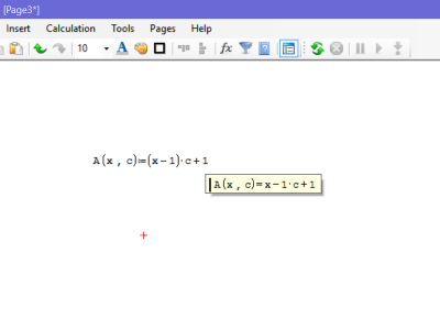

When the cursor is over an equation, it shows the long version of it. However, the tooltip equation (with the yellow background) misses often brackets, which makes the equation wrong. See attached:tooltipproblem.png

http://en.smath.info/forum/yaf_postst7437_Tooltip-doesn-t-show-brackets-properly.aspx

Thank you! Will fix it asap.
#4 Posted: 8/22/2016 12:47:19 PM
2,326 likes in 4,013 posts.
Fixed. Will not be an issue anymore in the next SMath Studio release.

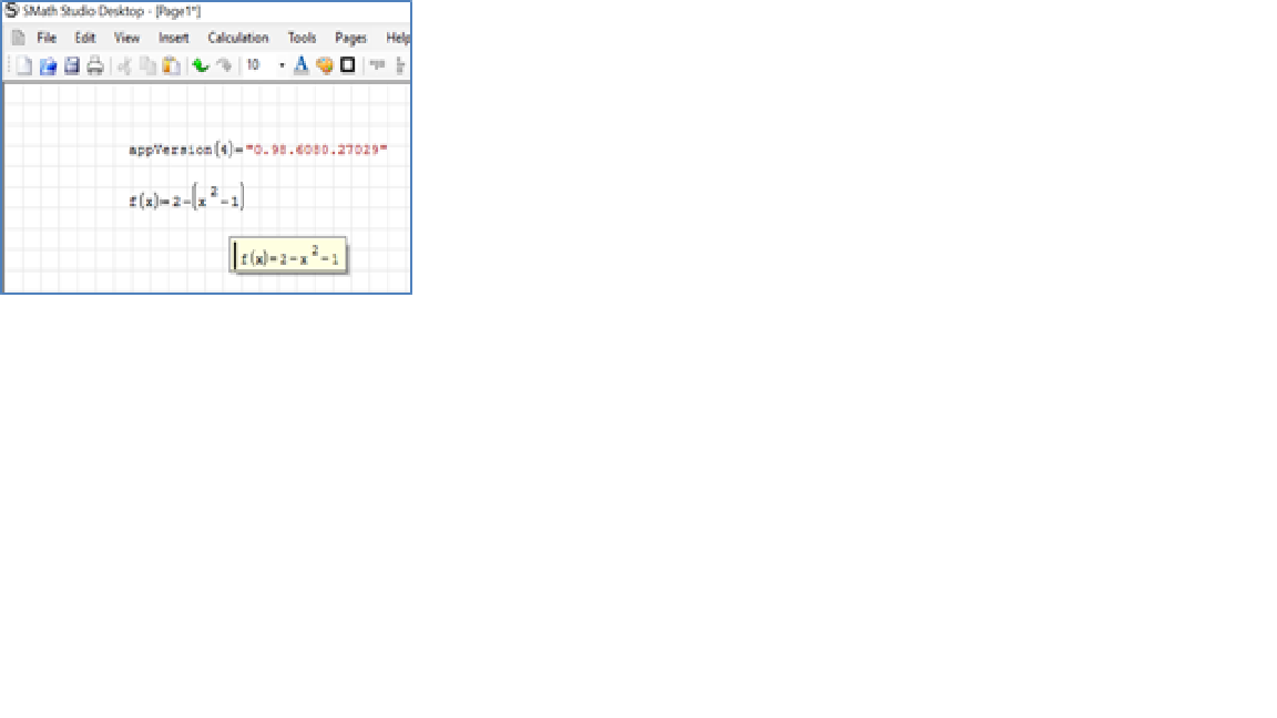

Tool tips problem.
Tooltip.pngTool tips problem
#6 Posted: 8/25/2016 4:55:03 PM
Fixed: http://en.smath.info/forum/yaf_postst7719_SMath-Studio-0-98-6081--25-August-2016.aspx

Thank you Andrey!
It works fine
