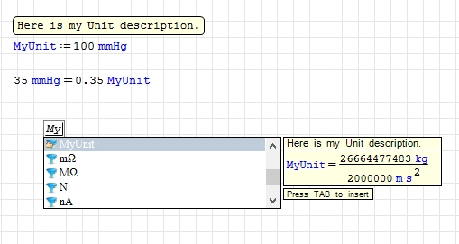

#3 Posted: 8/7/2020 1:04:38 PM
1,359 likes in 2,273 posts.
I think that the lang file are hardwired, no chance for ordinary users to add, you can just modify existing entries.
Thus, using the units.xml file lacks the chance of adding description texts. Also, this approach is non-portable. Your files won't work in an SMath installation without your particular units.xml.
You might use a snippet instead.
These are ordinary SMath files which can be embedded in any other file just by typing their name, usually as collapsed area region. And in ordinary SMath sheets you can define units with descriptions in whatever set of languages.
The advantage is that such files are portable. The disadvantage is that they aren't updated when you update your unit snippet.
This auto-update can be achieved using the plugin-mechanism. It also includes portability, as the dependence on plugin and version is stored in the sm file and any user with an installation lacking this plugin will be offered to download it from the online gallery in the extension manager.
Of course, you can ask Andrey to include your units in the next update. That would be the easiest and most straightforward way for the users.
This, however, would require you to stick to common standards and not to invent arbitrary units of convenience.

Hi. I agree with Martin. Also, in the standard way to introduce new units in SMath, you can add your own unit description, again, in the standard form.
I don't check if you can add different description for different languages.
