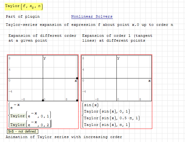

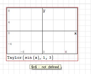

I found that if I try to draw a function in 2d plot using Taylor function, then it shows the error "$n$-not defined.
From the Martin's Handbook as well
#3 Posted: 10/15/2019 2:29:02 PM
Confirmed: it stopped working between SS 5346 SS 6179

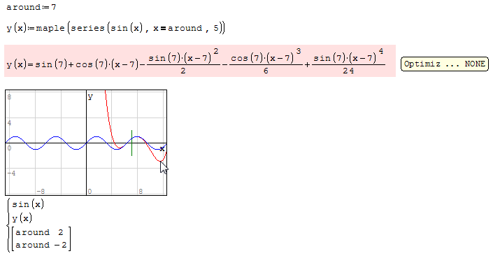

#4 Posted: 10/15/2019 7:24:19 PM
Besides College didactic, not much interest.
Modern CAS borrow from Windows, 21 D floating point,
standardized 15 D true vs Tables [Abramowitz & Stegun].
#5 Posted: 10/15/2019 7:52:16 PM
... more didactic [IMHO, of no interest].
Maple series.sm (36.51 KiB) downloaded 1365 time(s).
