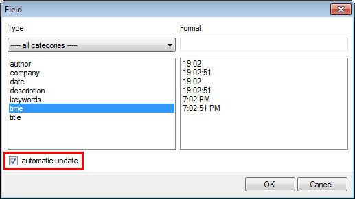

Good Day Davide,
I have used the "Field" functionality for a while now, in particular the "date" and the "worksheet info".
I have noticed that:
1. worksheet info field does not change if the actual smath file properties change
2. date changes the moment smath worksheets is re-opened
Is there a particulat reason for this behaviour? If you consider my suggestion worthwhile I propose to update the worksheet info fields every time the .sm file is opened to scan for changes. Also I propose to update the "date" field only when it is created or copied/cloned elsewhere - it would make sense to track the date when a particular calculation page in a .sm worksheet was created, not the current date/time at the instance of .sm file access.
A.M.

Hello Alex,
Yes, this is because the region is designed to have a low footprint and there isn't an event "File Properties Changed" for the worksheet; but I see that it doesn't changes even on file opening nor for region paste; I'll investigate it ASAP.
I suppose is matter of my habits; if I need a static date/time I write it directly or I convert the field to static text. However I realize that one might want it "less dynamic". What if I add a property for each field to drive the update? (whenever possible or just manual by context menu).
Thank you, Davide, both tweaks will be very much welcome, if and when you have time, of course.

PLUGIN UPDATED SMath Studio 0.98.5935 and later
  • Rendering logic refactored to be much more fast (smooth worksheet's scroll on huge regions or even on multiple regions intersecting the viewport);
  • Applied correction on characters' spacing to make them closer to common text editors;
  • Fields: added option to disable automatic updates;

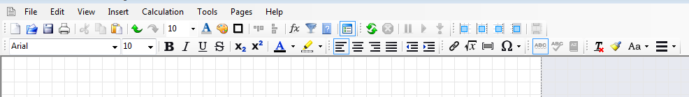

My procedure Win 7, micro laptop:
1. from the insert menu => click the W symbol [insert writer region]
2. the empty rectangle appears [|]
3. click right for the drop down menu => click left "settings"
4. as you start typing in the rectangle the movable tool bar is active.

That is the problem! The movable tool bar is active only after doing all that. It used to pop up @ step #1.
#72 Posted: 3/17/2017 11:21:16 AM
1,442 likes in 2,934 posts.
Have you tried to change your settings?
Please check your settings in the "More..." > "Options..." menu ("New regions" and "Environment" tabs). Settings should be saved once you click on "OK" and never change, except in cases mentioned previously.

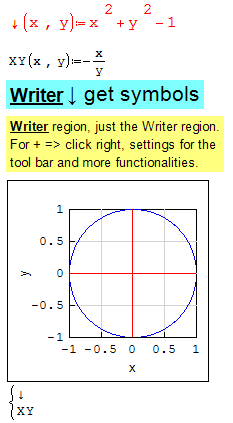

That is the problem!The movable tool bar is active only after doing all that.It used to pop up @ step #1.
Once you have entered the writer region you have minimal options:
click on a word to Ctrl+B, Ctrl+U [bold, underline].
For the tool bar: click right, click left on 'settings'.
The minimal and advanced options is very ergonomic [to me].
