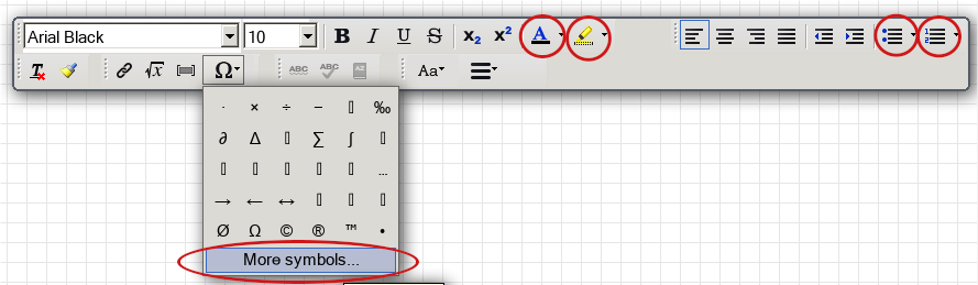

600 likes in 1,381 posts.
Circled buttons force crash smath on linux.
Bug occurs if I click on little triangles next to items.
I don't know if every linux distro has this bug.
#124 Posted: 11/17/2021 8:30:09 AM
I remember that was tested in Mint and Ubuntu...
If you start the program from Terminal you are able to collect some more info about the exceptions?
#125 Posted: 11/17/2021 8:43:48 AM
This is the error message:
