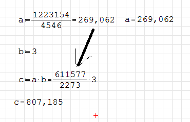

Hi everybody!
I'm beginner in Smath. I met a problem when use explicit function. I can't show values of variable in decimal format (in case it's irrational number).
In my example, please tell me How to show value of a in decimal format in expression of c. Thanks

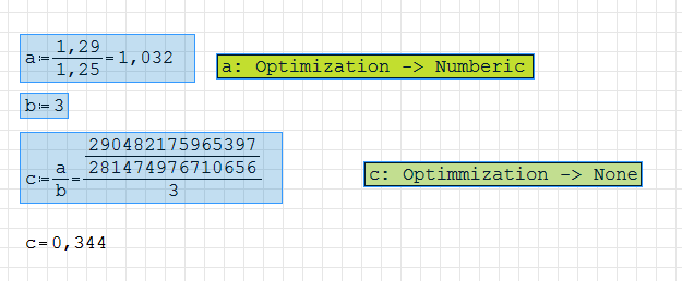

#3 Posted: 12/16/2017 12:29:21 PM
Maybe just click right for the "Numeric option"
If you define a:=1, b:=2, c:=3, d:=pi
MyStuff:=a*b*c*d ... what is the point to display
MysStuff=1*2*3*3.14159=

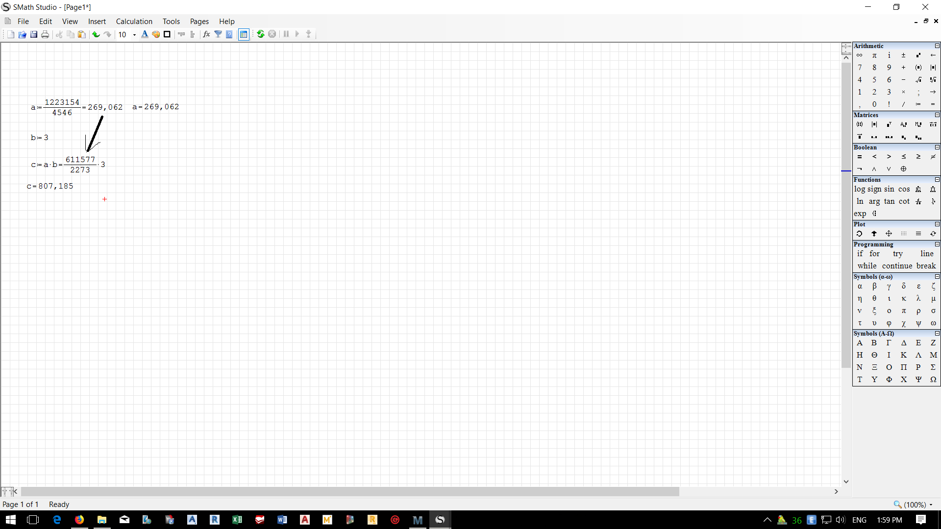

#5 Posted: 12/17/2017 6:58:27 AM
1,362 likes in 2,276 posts.
Ever heard of the windows snipping tool? It is already on board, no need to install anything.
Just type "sni" in the search field of the start menu.
If mouse cursor, callouts and the like are of importance, I use Greenshot.
I followed your instructions. But the problem remains unresolved. Do you have any other way?

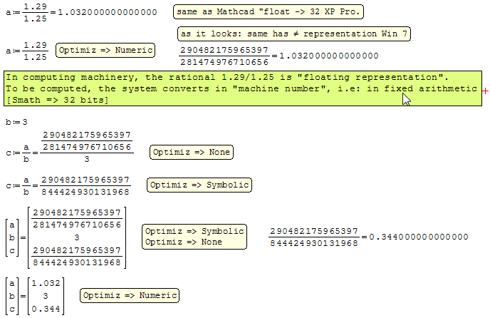

A Snippet + Work sheet to check consistency in you PC.
To get all the trailing 0' => set decimals 15 [first]
then set "Trailing 0's => 15.
If you visit Abramowitz & Stegun, you will find lot of
approximations are in fixed arithmetic rational fractions.
Does it help ?
Hanoi.sm (23.75 KiB) downloaded 1220 time(s).
