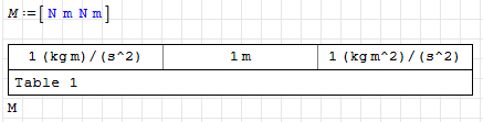

Hello Andrey, Hello Everibody,
Smath Matrix object is a very useful object.
I would like to propose some discrete separation lines between the cells (as Excel does, for instance), in order to facilitate the good lecture.
I think that the problem belongs to SMath main program and do not to plugins zone.
Thanks,
Ioan

Thank you Jean,
It's interesting what you mention but my objective is another - easily identifying visualy a cell content.
Salut,
Ioan

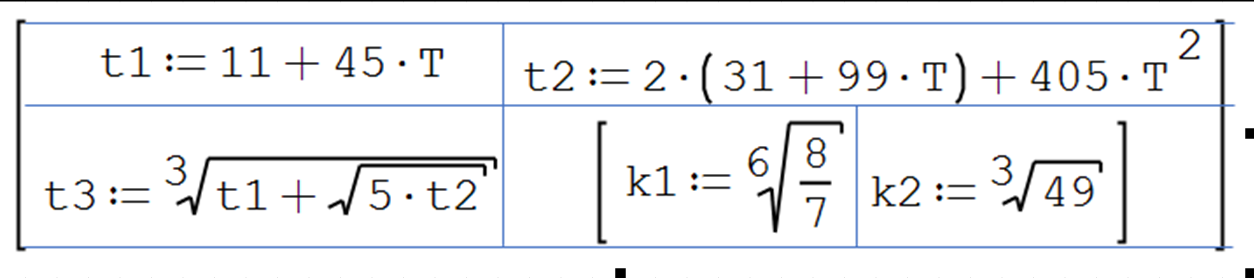

#3 Posted: 10/22/2023 3:19:10 PM
1,359 likes in 2,273 posts.
Thanks,
Ioan
I support this proposal. Here is an example where it is nearly impossible to visually recognize which spaces separate matrix entries and which separate factors. It could be mitigated by a smaller gap between factors (in those cases where the point is ommitted).
If the matrix grid is introduced, then there should probably be an option to control printing appearance just like with the background grid.

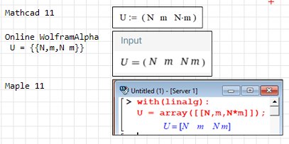

Hi Ioan. I know that your improvement is very good to achieve better visualization in SMath. However, comparing how the matrix is displayed with other software, I think the main problem is that we need some more space between the matrix elements.
Putting all together
However, it would be very interesting to also have the options you propose.
