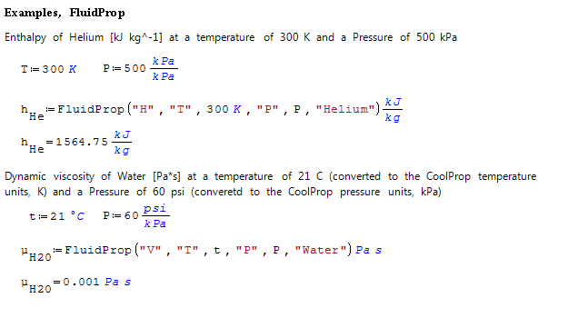

Distributed with the most recent version of CoolProp (4.0.0) are PTC Mathcad “User Function” libraries, designed to wrap some of the primary CoolProp functions and make them available within PTC Mathcad worksheets. There are wrapper libraries defined for both PTC Mathcad 15.0 and PTC Mathcad Prime 3.0. The CoolProp wrapper source code for PTC Mathcad is also open-source and distributed freely on the CoolProp website.
In addition to the source code, there are pre-compiled libraries (.dll files) for both PTC Mathcad 15.0 and PTC Mathcad Prime 3.0. The provided PTC Mathcad 15.0 .dll was compiled/built in a 32-bit environment. The provided PTC Mathcad Prime 3.0 library was compiled/built in a 64-bit environment. If using a PTC Mathcad environment other than the two mentioned, there are build-scripts and instructions distributed with the source code, enabling users to build the CoolProp wrapper library specific to their environment.
Wrapper of CoolProp for MathCAD 15
copyright Scott Polak and Ian Bell, 2013
To Use
* Copy the CoolPropMathcadWrapper.dll file to C:\\Program Files (x86)\\Mathcad\\Mathcad 15\\userefi or equivalent for your version

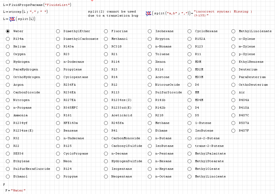

I used the wrong dll (from excel and dll subfolder).
Now the library seems to work. Just strSplit() is undefined.
Maxima has a function split(string, delimiter), however, due to a translation bug only the default delimiter (space) works. Therefore, the kommas have to be replaced by spaces first.

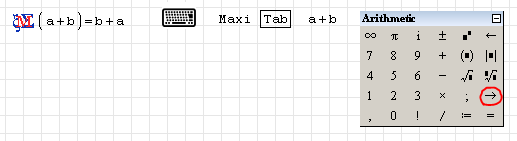

A quick test would be to type Maxima TAB a+b and evaluate that symbolically (-> button in the arithmetics palette).
Yet I do not expect Maxima to run, as it has never been tested under Linux in the development. Under linux, Maxima can hardly be run by starting maxima.bat, as done by the plugin. There might be a chance in wine, but I haven't heard of any success.
