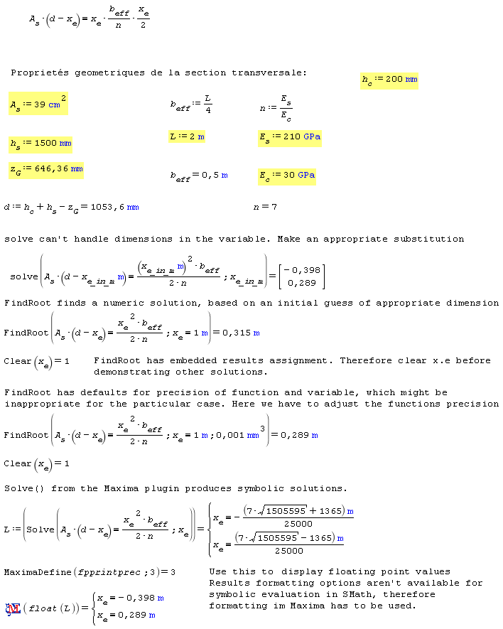

#8 Posted: 3/2/2018 9:46:16 AM
joao sousa
joao sousa
0 likes in 4 posts.
(Please ignore my post below - I can see the files have been uploaded after all b)
Iff someone could have a look at the .sm file I have attached, I would be very grateful.
Many thanks,
Joao
SMath_equation solver test.zip (1.59 KiB) downloaded 588 time(s).
SMath_equation solver test.sm (8.23 KiB) downloaded 1564 time(s).
SMath_equation solver test.sm (8.23 KiB) downloaded 1526 time(s).
Hi ALL,
Many thanks for you interest and responses. Apologies for not having responded but I have been away from the office. I am trying to attach an .sm file, but for some reason this is not working... Any thoughts?
Thanks,
Joao

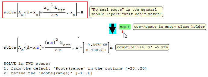

"NO real roots" from the solve bloc is an absolute pest [not to say stupid].
SMath_equation solver test (1).sm (11.49 KiB) downloaded 1500 time(s).

With regards to your responses, I appreciate the need to make an appropriate substitution to overcome the fact that solve can't handle units in the variable; However, I can´t seem to assign the unit to the variable, within the equation (apologies for being thick). I've tried typing x'm, tried using ctrl+w to assign meters unit to x, but still haven't managed to make it work. A bit frustrating... If anyone could be so kind to shed some light here, that would be greatly appreciated.
Many thanks,
J

Type x*'m or x* and then insert the unit from the dialog into the empty placeholder in the right of the multiplication dot.
Multiplication operators in front of units aren't shown.

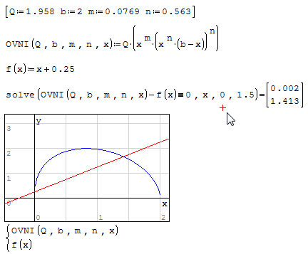

I'm having a similar problem, it works on wolfram and symbolab, but not in Smath.
#16 Posted: 12/28/2019 11:32:16 PM
Always plot first ...
#17 Posted: 12/29/2019 9:09:09 PM
I somehow missed the option to use the 2nd solve function with root limit, but I didn't need a plot for this, so I used it in one line and everything worked out fine.
I can't click the thank button, so thanks.
#18 Posted: 12/29/2019 11:01:26 PM
If you don't plot, you will soon hit the wall.
That will help set the limits.
When applicable, "implicit roots" is often + accurate.
