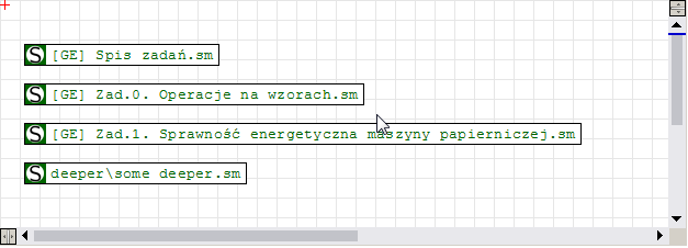

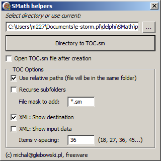

Hi, I just needed to make a table of contents file built from hyperlinks. I installed Hyperlink Region of Davide Carpi but found creating hyperlinks to be too uncomfortable for many files. So I wrote small (Windows) program to facilitate this functionality. Tested on Win7/64, Win10. I'm not sure if i did not do something already done. Screenshots and exe file attached.

Jean, gabben is right. My sample case was different: I prepared about 30 sample files for students. I simply wanted to make list of samples in the same format as they are (i had to have it also as PDF file). I am aware that this is not a browser replacement. If it matters I can prepare plug-in some time (if i grab more python or c#), I think it could be trivial for Davide. Here is upgraded version.

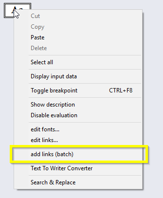

There is the text region utilities (but works on text region hyperlinks, thus *.sm and *.smz files only)
Can I add your utility in the wiki?
