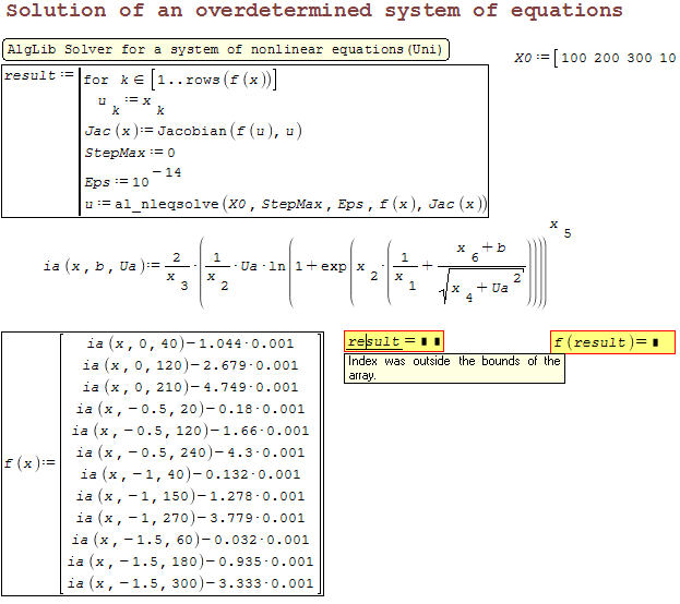

I'm sorry, but again I have problems using this type of algorithm - see the attached image.
#125 Posted: 7/26/2018 5:30:25 PM
Just open and run my latest work sheet, posted today.

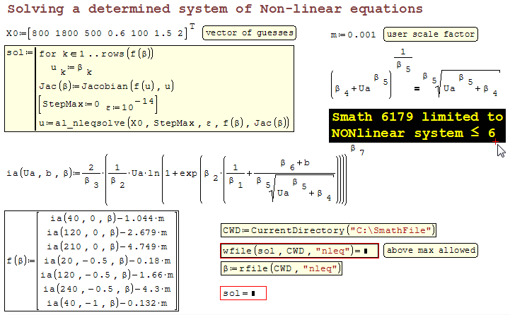

If you run 6671, your al_nleqsolve(,,,) needs be updated as well.
"Out of index..." => too many equalities wrt parameters.

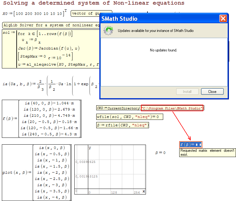

There are no updates for my 6671. For my SMath directory, I still have errors.
Nicolas
#127 Posted: 7/28/2018 8:07:01 AM
My Smath is as well in C:\Program
But all the work sheets are in C:\Smath 6179
Where you have all your Smath work sheets, add a New Folder,
name it "SmathFile" [typical or else]
address CWD:=CurrentDirectory(......)
#128 Posted: 7/28/2018 2:28:06 PM

What do you call SMath Worksheet? I searched for these two words across my computer and I have no results. Is there a folder where you store all SMath files? I do not have a single folder for this purpose. I store sm files for each domain and I therefore have a whole library of sm files stored in folders with different names. That's why I do not store these folders in the C partition of the system, but in a D partition structured by domains of interest.
... Is OK. I have entered the address of one of these folders, where I stored the examples from Ber7. I see it works. Perhaps that address should be the folder where the file is stored.
Nicolas.

#130 Posted: 7/28/2018 5:04:04 PM
When you click on the Samth icon from the task bar, what does it do ?
It opens a work sheet of the number pages needed to complete the project.
All my work sheets are stored in a single folder C:\Smath 6179 [about 1600]
A global single file where to store/transit some reference modules, transit
some data to avoid re-computation, store images ...etc is all what I need
and this file is in C:\SmathFile ... from CWD:= CurrentDirectory("C:\SmathFile")
then, I address whatever can be filed for purpose.
My C:\Smath6179 contains 1554 work sheets, all categorized mnemonic,
easy to retrieve, for instance: Solve is a large category [101 work sheets].
Much easier to glance top to bottom through 1554 than having about 50 different
folders according to projects categories.
In < 2 sec, I retrieve any of my specific project [Instrumentation],
just the time to scan down 101 items.
BTW, you don't have to spool to file 'sol' ... just = but wise to
copy/paste in β:= as an independent/isolate vector.
Cheers

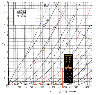

I believe that the function:
does not exactly represent the values of the Triode ECC83 graph (Tesla Graph).
Here is a comparison:
Levenberg_Marquardt_Code_CBG_Jean_Tesla_Test.sm (1.45 MiB) downloaded 1376 time(s).
