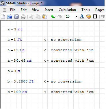

I've been playing with a Units.xml file for US/Imperial units and discovered that sometimes Imperial (UK) units are slightly different. So let call this US Standard units.
I've translated Units.xml with default lb and ft. Although I'm uncertain how to translate some especially electrial units and some of the atomic mass units. If someone can help please let me know.
Below are two seperate runs one using the SI units file and one using the US units. It seems Andrey has done a good programming job since I can swap these at will.
US Units
SI Units
Ed
