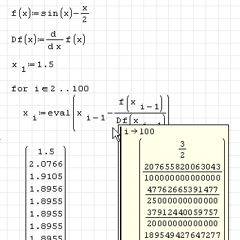

Just use "eval" function in for loops:
x(i)=x(i-1)-eval(...
y(i)=y(i-1)-eval(...
The symbolic engine will produce complicated expressions in this case and slow down the speed. The symbolic engine will be avoided and, therefore, the speed of the numerical calculation will be drastically increased.

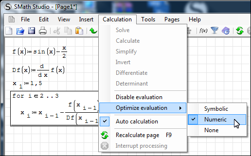

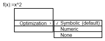

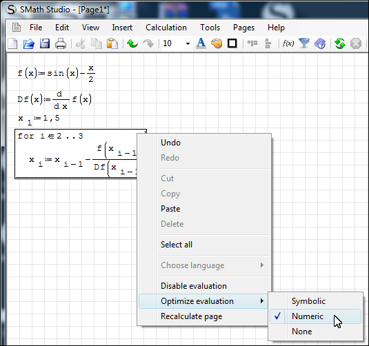

Done. Results is pretty good (see tests at the end)
Figure 1: Setting of optimization option using main menu.
Figure 2: Setting of optimization option using context menu.
Figure 3: Results of evaluation.
Updated (Performance tests):
If "i" defined within the range from 2 to 10:
  • Numeric optimization - takes 0.016 sec. to evaluate.
  • Symbolic optimization, with eval(..) function - takes 0.015 sec. to evaluate.
  • Symbolic optimization - takes about an infinity (interrupted after 13 min. elapsed) to evaluate.
  • Without optimization (None) - takes 2 min. 53 sec. to evaluate.
If "i" defined within the range from 2 to 1000:
  • Numeric optimization - takes 29.97 sec. to evaluate.
  • Symbolic optimization, with eval(..) function - takes 17.352 sec. to evaluate.
  • Symbolic optimization - senseless action.
  • Without optimization (None) - senseless action.
