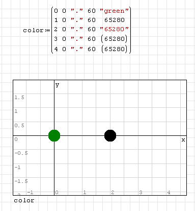

Only a little question: I was trying with numbres instead color names, but no result. I tryed the following:
#5 Posted: 10/11/2010 8:53:08 PM
2,344 likes in 4,057 posts.
Ah, yes... I forgot about opacity First component should be opacity and the next ones are as described above, so Green is equal to FF00FF00. But the logic now becomes more complex. Because of the maximum 32-bit integer is 2147483647 (0xFFFFFFFF/2) and FF00FF00 = 4278255360 (i.e. greater then the max. integer), then Green is FF00FF00-0xFFFFFFFF-1=-16711936. Hope I've described it...

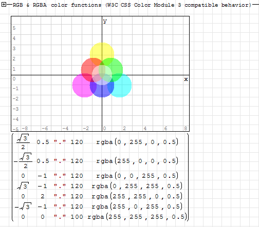

I used your snippet to develop one that behaves similarly to the functions rgb and rgba used for websites (CSS3 behavior compatible)
r,g,b must have values from 0 to 255; alpha value must be from 0.0 to 1.0.
Decimal numbers in r,g,b does not cause the blocking of the function, like negative values or values greater than 255 (or 1.0).
here is the snippet: RGB-RGBA colors.zip
here is the *.sm example shown in the figure: RGB-RGBA test.zip

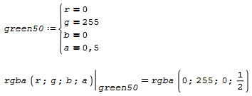

I wish to declare a color as green50 which is rgb green with 50% opacity.
green50:=(0,255,0,0.5)
and then use it (ie pass green50 as a variable) with Davide's rgba snippet:
rgba:=(green50)
Thanks in advance.
#16 Posted: 11/20/2022 8:27:40 AM
1,362 likes in 2,276 posts.
OK, one more try:
rgba:=(green50)
Thanks in advance.
If you just want to store the input to rgba() in a separate variable and apply it later, then you might use the at() substitution function. Yet it is not clear to me, why one would do that instead of just storing the resulting color string from rgba()
Blatt5.sm (3.17 KiB) downloaded 1406 time(s).
Mark R Harris 11/20/2022 3:26:00 PM
