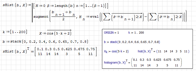

1,138 likes in 1,805 posts.
Hi Valery. This function returns the same result as mathcad.
sHist.sm (15.24 KiB) downloaded 1423 time(s).

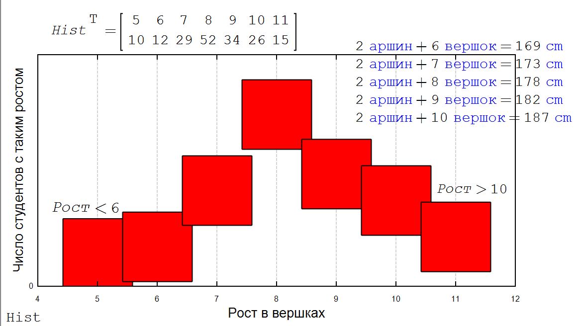

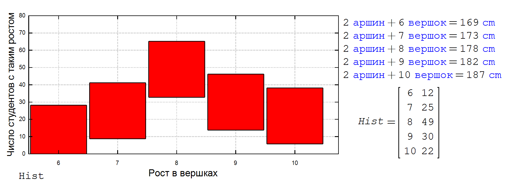

My students histogram

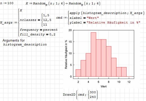

1,359 likes in 2,273 posts.
Maxima has a histogram plot function.
Taken from DOI: 10.25933/opus4-2949. The PDF has attached SMath documents.
Valery Ochkov 10/11/2023 8:23:00 PM, Oscar Campo 10/11/2023 9:42:00 AM
Are you looking for something more ;like this?

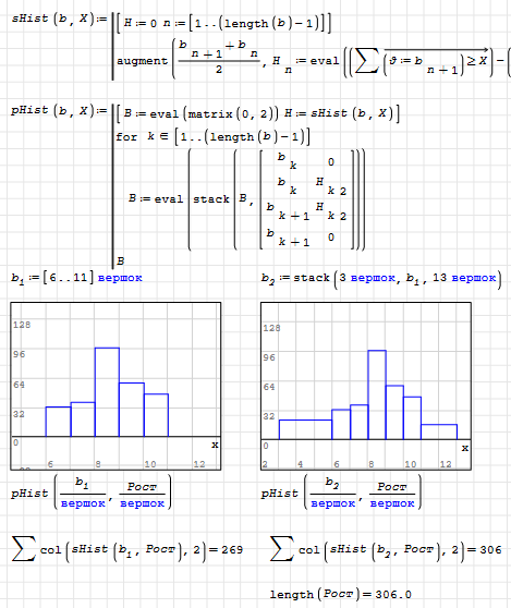

Hi. This version also works with unequally spaced bins.
pHist Mister-Class.sm (61.58 KiB) downloaded 1429 time(s).

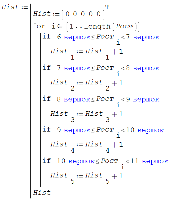

A Live histogram

My KISS Histogram

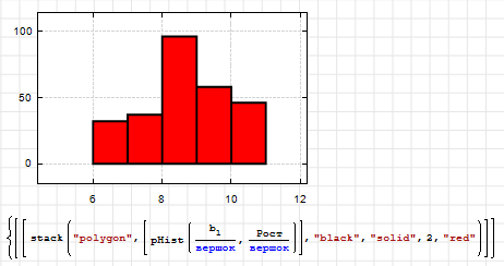

Hi. You can use the above pHist within XYPlot.
