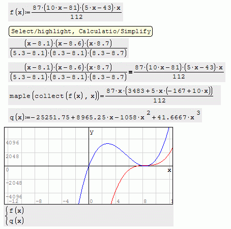

see the pic; up is line shap and down is math.
http://www.4shared.com/download/9EaKqwLice/__1_.PNG?sbsr=77166427c181ab16070234c6d9cf9e37969&lgfp=3000
How can I get this q(x) quantity cus it is the thing that I want and couldn't get it with Smath? do you enter it by typing or what? how do you got it?
and yes my 1st Eq.= my 2nd Eq.
what is "mape" that u enter?

this pic here shows math(down) and line (up)
http://dc595.4shared.com/download/9EaKqwLice/__1_.PNG?sbsr=77166427c181ab16070234c6d9cf9e37969&lgfp=3000
And yes my 1st Eq. = my 2nd Eq. and it is the q(x) from your pic, and it is the thing that I want to get but I couldn't fet it with Smath, so did you write(defind) it or what?
