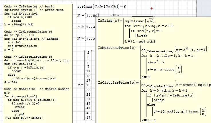

This function take the script in the variable description and try to convert it into a SMath function.
Code.sm (43.79 KiB) downloaded 1851 time(s).
Code.pdf (185.65 KiB) downloaded 1137 time(s).

Updated for if(2), if(3) and if(4).
Code.sm (58.16 KiB) downloaded 1744 time(s).
Code.pdf (244.84 KiB) downloaded 1099 time(s).

Updated. Some few new features added.
Code.pdf (606.82 KiB) downloaded 1142 time(s).
Code.sm (111.07 KiB) downloaded 1769 time(s).
