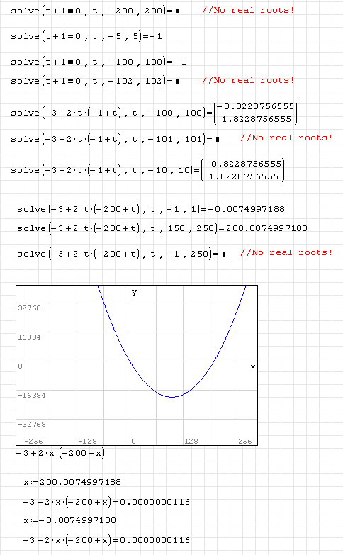

I think there were few posts devoted to "solve" function. Please look at the picture
A numerical algorithm is behind the scene of "solve". Numerical nonlinear solver is always a "tricky" task. I think there might be some general advice concerning "solve" realized in SMath Studio.
1. Plot the function first and locate the roots.
2. It might be more advisable to use the third and fourth argument (range) were the roots are located
3. It is not advisable to use large ranges. Actually, "solve" might fail in that case.
4. If it fails, then try to locate the roots one by one with an appropriate range search.
I am not sure about all of it, but it works.
EDIT: For polynomials use polyroots. This will give you all the roots (real and complex) of a polynomial (zeros of polynomial equation).

Your calculator presumably uses the quadratic formula for quads and Cardano's formula for cubic equations.
SMath, on the other hand, uses bruteforce. This has the advantage that it allows roots of any equation to be found by trial and error, but it means only roots within the range can be found. So increasing the range means more roots can be found but might take a few milliseconds longer. I think changing the range to something like -1000 and 1000 would be fine.

Well I'm not really sure how the solve function is implemented, but for sure it is some kind of Newton scheme to calculate the roots.
Thus bigger ranges could introduce some convergence problems (maximum allowed iteration steps, maximum error estimator).
Therefore it is not really a "good" solution to increase the range. Much better and often announced is to localize to roots and set a appropriate range.
These are ordinary numerical problems and would not show up if the solve function works symbolically (which is not always possible).
