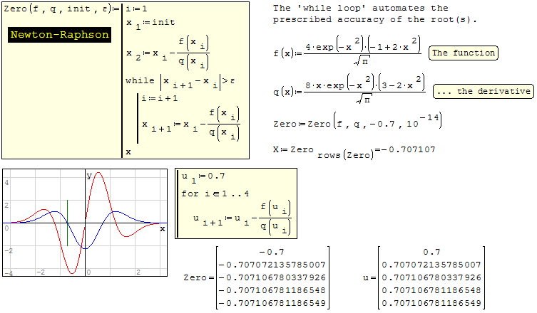

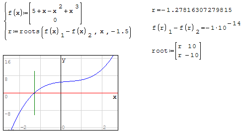

Davide, Alex ... thanks for the distiller-solution.
Two points about your Newton-Raphson example:
1. Will it work for this application in traditional code ?
2. Two [2] pitfalls:
2\a. about your cubic, it is ill-posed. In maths, it is paramount
polynomials are expressed in Lagrange canonical format.
For quick getting the polyroots and set the cubic solver.
In fact, cubic may have complex roots [your example is cubic complex].
Complex solutions are essentials in modeling/solving Control Systems.
2\b. The Smath native "roots" solves directly your example.
Rev(2) most appreciated for eventual hard solving future.
Solve roots Newton-Raphson.sm (51.05 KiB) downloaded 1242 time(s).
