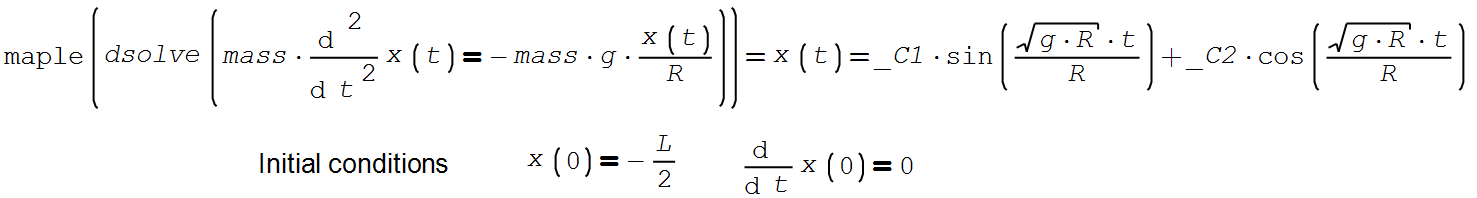

#1 Posted: 7/1/2023 5:56:48 AM
Valery Ochkov
Valery Ochkov
67 likes in 708 posts.
See please one ODE symbolic solution without IC
dsolve.sm (4.93 KiB) downloaded 1452 time(s).

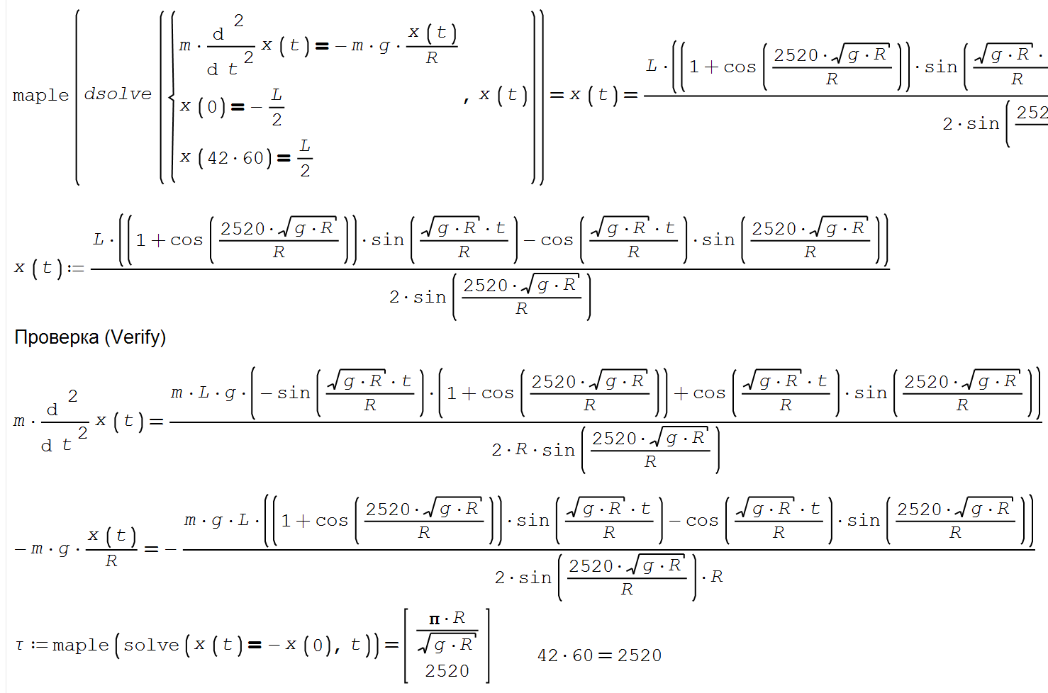

#2 Posted: 7/1/2023 7:55:36 AM
We have it done for exporting formula c/w constants & IC
ODE_Laplace 2nd [Type 3].sm (34.42 KiB) downloaded 1181 time(s).
Valery Ochkov 7/1/2023 9:20:00 AM
#3 Posted: 7/1/2023 9:20:10 AM
Valery Ochkov
Valery Ochkov
Thanks!
But no way to do so in SMath

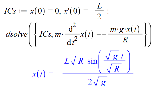

#4 Posted: 7/1/2023 10:51:35 AM
Valery Ochkov
Valery Ochkov
Thanks!
"L & m" are missing in dsolve result ?
m is missing in dsolve.

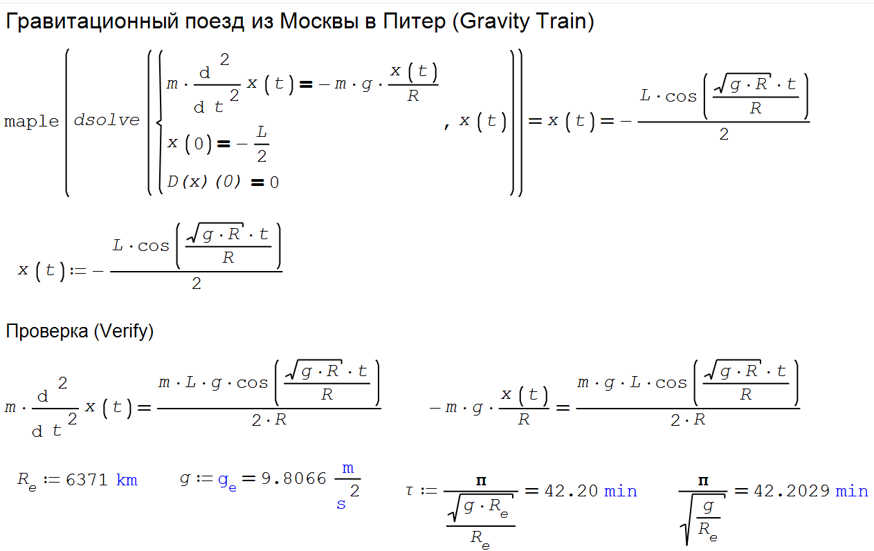

#5 Posted: 7/1/2023 2:48:44 PM
1,138 likes in 1,805 posts.
Hi Valery. Use Ctrl+Shift+K for write D(x)(0), which means x'(0)
Valery Ochkov 7/2/2023 4:05:00 AM
#6 Posted: 7/2/2023 4:06:01 AM
Valery Ochkov
Valery Ochkov
Thanks!
dsolve-ICs.sm (10.61 KiB) downloaded 1486 time(s).
#7 Posted: 7/3/2023 3:43:12 AM
The distance between the cities added.
GravityTrain.sm (31.01 KiB) downloaded 1391 time(s).
GravityTrain.pdf (233.1 KiB) downloaded 892 time(s).

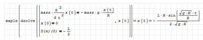

#9 Posted: 7/4/2023 2:14:47 AM
Valery Ochkov
Valery Ochkov
The Boundary problem?
dsolve-Boundary.sm (17.01 KiB) downloaded 1440 time(s).

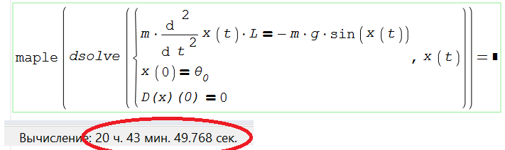

#10 Posted: 7/4/2023 9:30:11 AM
Valery Ochkov
Valery Ochkov
A pendulum
#11 Posted: 7/4/2023 6:53:08 PM
A pendulum ...
The exact solution needs some handwrite work.
Edited: a hard handwrite work. Previous version was wrong.
Click to enlarge
Correct solution -> pendulum v2.sm (13.73 KiB) downloaded 1425 time(s).
Wrong solution -> pendulum.sm (13.88 KiB) downloaded 1427 time(s).
