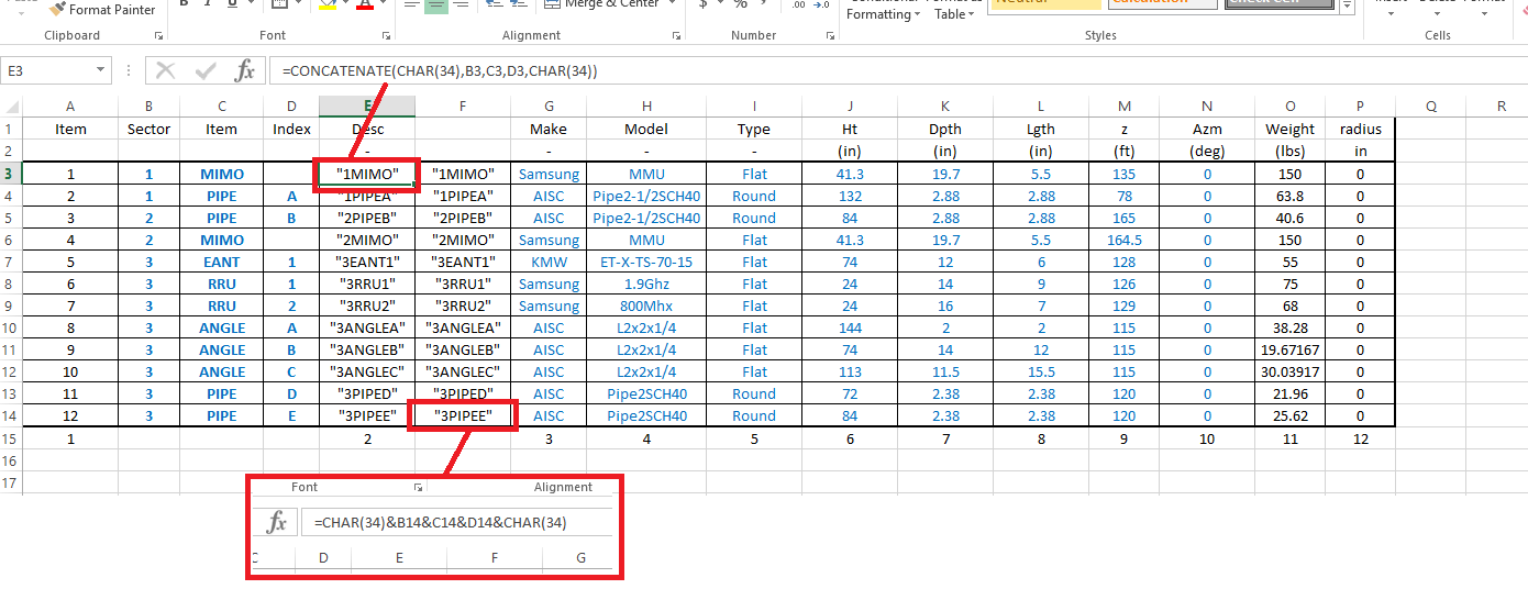

Is there a description somewhere of how SMath reads in cell data from Excel?

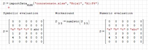

I got tripped up trying to use data in cells that were the results of combining cell values both with concatnate() function and by tying to use the =A2&B3$C3 trick to combine cell values. Eventually, I tricked it by using Char(34) for a quote because Excel didn't like a quote within quotes or with escape like this "\"".
I could not tell how SMath was reading in those values- it was reporting that the values were undefined. It seemed to be taking the cell values as equations instead of results. Which in thinking about it is handy when you are trying to pass on equations, but not so muich if you are trying for results.
I thought to manipulate it via var2str() but I could only do that if the data was already imported.

In Excel I enter the data as text and want to manipulate it there. Excel is a little bit easier workflow wise to move and traverse the cells to edit the text. Cells in blue are user entered. The ones in black are the result of some manipulation. There is much repetition in these calculations.

Here are the two ways I came up for workarounds- to use the ASCII reference to quotes then SMath knows it is text, not a variable or definition.

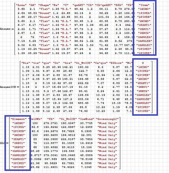

So I read that first spreadsheet in and define a matrix "Equip", the call the elements from that to do a bunch of 'work'. I consistently reuse the index value of the item to track it through the calculation process. The results then get passed off to other worksheets or spreadsheets.

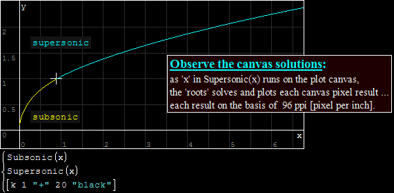

Essentially, Smath is an advanced CAS equation editor. High quality plot on canvas.
Smath is exceptional for publishing. Mach # exemplifies mostly:
1. Solves on the canvas
2. Integrates on the anvas
3. Easy continued fraction from the keyboard.
Mathcad 11 was mostly used to read Excel data, not the other way around..
Good luck to script a continued fraction in Excel. I have some CF 15 terms long !
