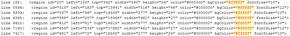

#4 Posted: 11/17/2014 8:19:02 PM
1,442 likes in 2,934 posts.
You're welcome csb
Yep, I've used notepad++ (encoding: utf-8; language: xml)
As first step you have to check the XML structure. You should see something like in the first picture attached.
The most common issue is that the file saving crashes and produces a broken code. In this case you have to remove/restore the last region and close all the tags from the inner to the outer (that must be </regions>. This is not the case of your file.
When the first step is not resolutive, as second step you have to find the source of the pain... The simplest way is a "binary search". Collapse all and then delete some regions, then try to open the cleaned file, until you have a working file. Then restore the file and remove less region until you have few candidates. Because I don't know what was the work that you have done in your last session, I've started my research from the bottom of the worksheet, removing 1,10,50,100,200,300... regions. Making the long story short, I've found that the problem was in more than one region, where the first was the 20th. The first idea was for some invalid character, so I've replaced your text with a simple test. Because nothing changes I've checked again and I've found the bug in the bgColor attribute.
In this case I've searched all the occurrences of "#fffff" and I've found all the issues (just my luck), the 2nd way would be a search with regular expressions or again the 2nd step for another different bug.
Even if you fix the issues yourself, I reccomend to share them here or in the BTS (also with simplified examples, when possible), to have further versions more stable
Best regards,
Davide
P.S. Bug registered as SS-1247
