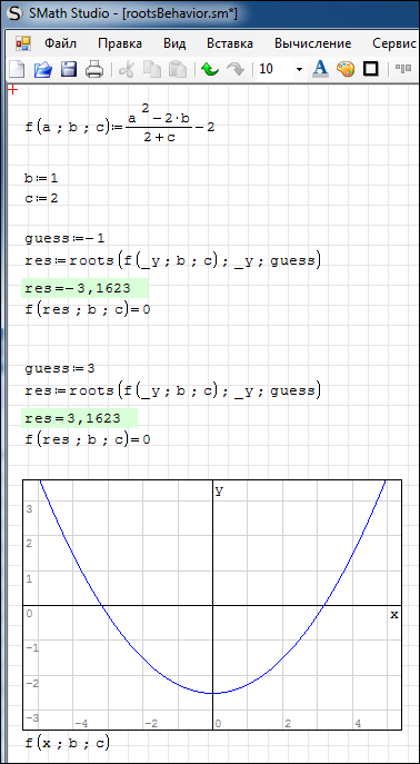

I can not see why roots() is working wrong with the second guess value.
Could someone reproduce this please, or tell me if I am doing anything wrong.
If you can reproduce - this might be a bug, or something wrong with my computer (WinXp, SMath v0.89.8 Portable).

Take a look at the previous example, please. If you use b=1, c=1 the result is correct, but if you use b=1, c=2 then it is not correct.
[MATH=eng]f(a,b,c):{a^2-2*b}/{2+c}-2[/MATH]
[MATH=eng]b:1[/MATH] [MATH=eng]c:1[/MATH]
[MATH=eng]roots(f(x,b,c),x,-10)=-2.8284[/MATH]
[MATH=eng]roots(f(x,b,c),x,10)=2.8284[/MATH]
[MATH=eng]b:1[/MATH] [MATH=eng]c:2[/MATH]
[MATH=eng]roots(f(x,b,c),x,-10)=-3.1623[/MATH]
[MATH=eng]roots(f(x,b,c),x,10)=10@#[/MATH] - WRONG
or
[MATH=eng]roots(f(x,b,c),x,10000)=10000@#[/MATH]
but if you put something like
[MATH=eng]f(a,b,c):{a^2-2*b}/{2.0000000000001+c}-2[/MATH]
the result is RIGHT! Moreover, Instead of 2+c in the denominator you can put 4+c, 6+c -4+c or any other even number instead of 2 and there will be wrong again. If you put any odd integer (positive , negative) or a real number, the result will be right.There must be some bug here.
[MATH=eng]roots(f(x,b,c),x,10000)=3.1623@#[/MATH]
On the other hand
[MATH=eng]solve(f(x,b,c),x,-100,100)=mat(-3.1623,3.1623,2,1)[/MATH]

Fixed.
Best regards, Andrey Ivashov.
