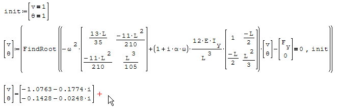

FindRoots ignores Units. Code the image first.
Solve FindRoots Complex Forum.sm (11.09 KiB) downloaded 1504 time(s).

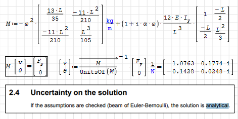

Besides correction of the unit mismatch, Solve seems to want the matrix equation in homogeneous form.
Matrix equation_Kr.sm (14.1 KiB) downloaded 1425 time(s).
#9 Posted: 6/13/2023 6:25:48 PM
1,139 likes in 1,805 posts.
Hi. Another way.
