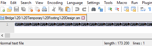

My notepad++ shows a long sequence of null control characters (unicode \u0000)... at least we have a date, this is an important clue... me too I remember at least another file like this (linked below)... keep reporting if it happens saving with most recent 0.98 versions...
2018-03-17 02_03_47-C__Users_Davide_Downloads_Bridge%20-%20Temporary%20Footing%20Design.sm - Notepad.png
For future reference (sorted by date):
- Changes on save were done in SMath Studio 0.98.5935 (threads, fixed that nasty issue about background images on big files, ...);
- File corrupted on November 2016 - there was SS 0.98.6128 (stable) as latest release;
- Save logic refactored in SS 0.98.6398 (beta) (introduced double-step saving);
- Save logic improved in SS 0.99.6626 (beta) (errors handling);
The other file with same issue (multiple null control characters) reported here; no informations here about the last modified date or the SS version in use by the author of the file.

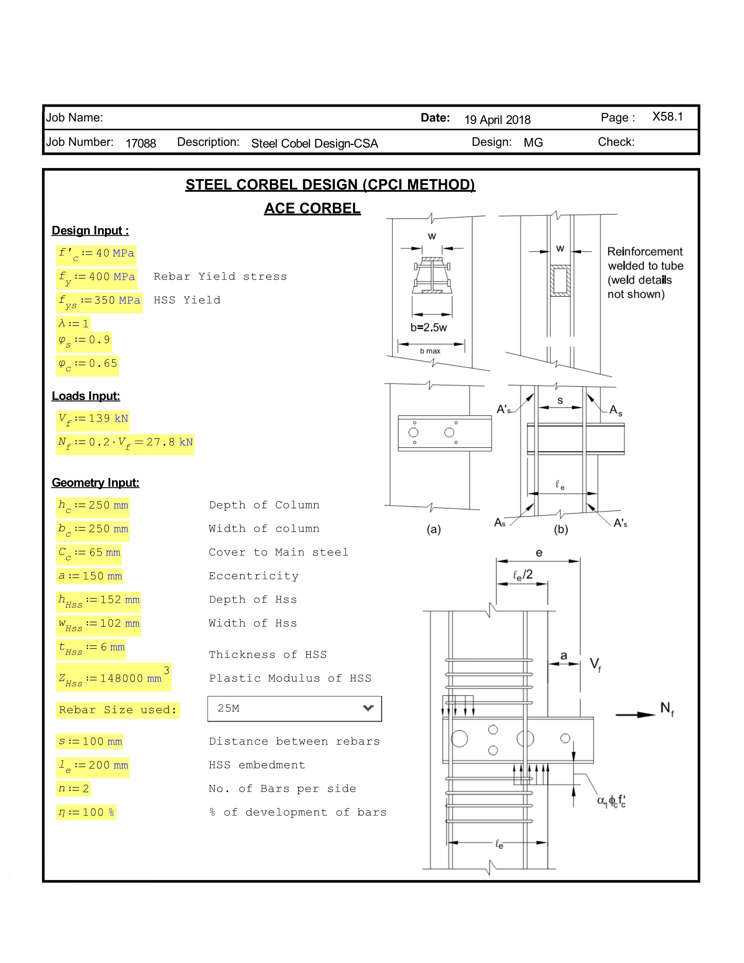

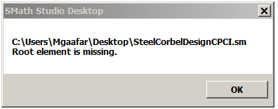

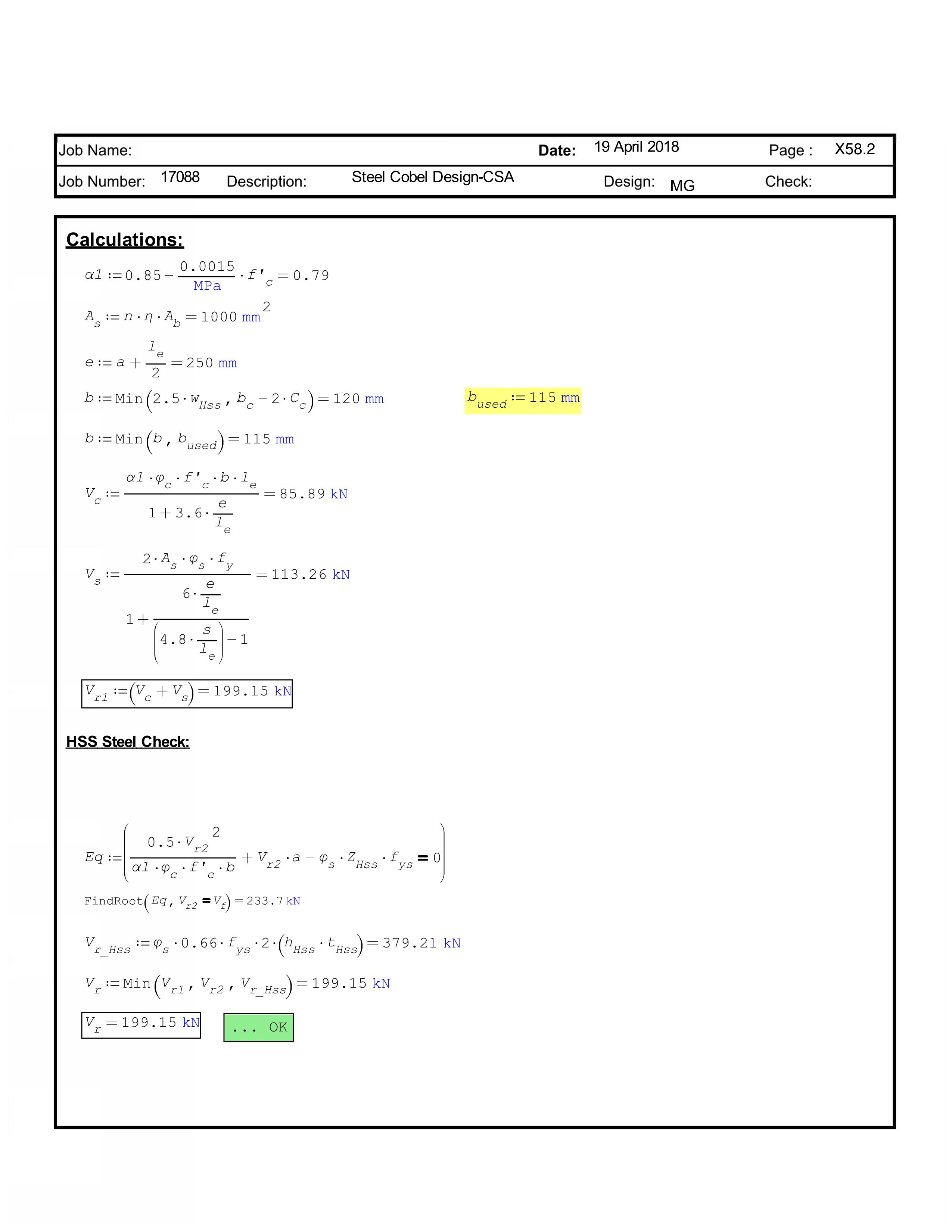

Hi, I was trying to open an Smath sheet but I always get this error message:
"Root element is missing"
the problem is all the copies that I have don't open and give me the same error.
Does anyone know how to fix this error?
I am also attaching a snap shot of the sheet that I had it printed before for reference.
Thanks

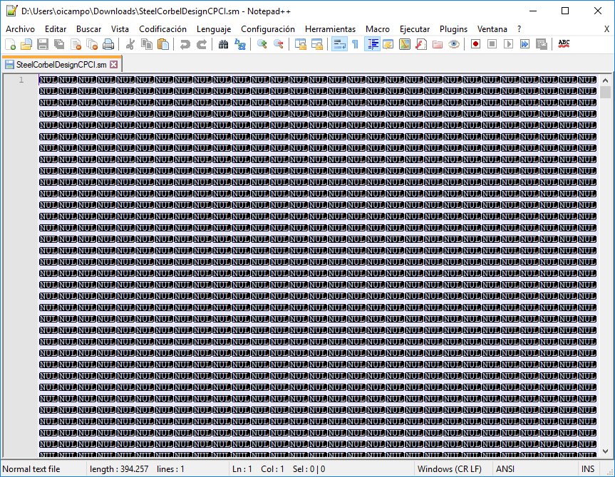

this is a weird issue.
I opened your file on Notepad++ and I found that is full of NULL characters. Same you can see in any other text editos (atom, and so on)...
Sorry...
