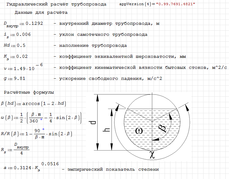

Hydraulic calculation (rus).sm (42.41 KiB) downloaded 1269 time(s).
