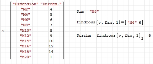

Hi. You have findrows in SMath

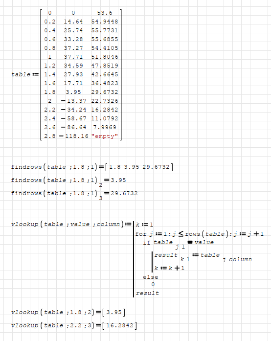

You can either use findrows() as Razonar mentioned.
Or you can use custom written vlookup() function uploaded before.
But I would stick with findrows() if I had to choose.
Worksheet1.sm (8.43 KiB) downloaded 1069 time(s).
