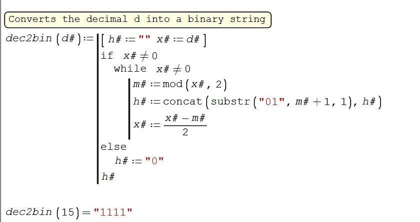

Epic dredge sorry. Functional, with all credit to @Razonar (source/author).
20221227 Dec2bin.sm (4.5 KiB) downloaded 1738 time(s).

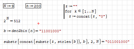

Do you know a way to implement a fixed 9-bit binary counter in SMath (or display a decimal counter in fixed-length binary)? This is probably a bit too esoteric to be a feature request...

bin_counter.sm (9.7 KiB) downloaded 1650 time(s).

Modification of Razonar's dec2bin() should work well.
dec2bin(p,q) where p is the bit-field length and q is the decimal number to be converted.
Check the converted string's length and then pad the front with zeros to suit.

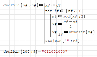

Maybe this can be useful.
dec2bin.sm (3.8 KiB) downloaded 1628 time(s).

I spoke too soon! Bit-testing don't work so well on a string.
A much better idea is a column vector with each of the 9 (ie n#) elements being either a one or a zero.

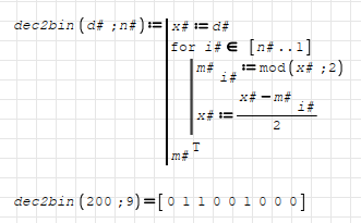

#18 Posted: 12/30/2022 5:09:06 AM
600 likes in 1,381 posts.
This was what I coded first, after that I made it to string.
Here is what you have asked for.
dec2bin.sm (6.09 KiB) downloaded 1615 time(s).

5 likes in 90 posts.
Thank you so much overlord, that is both elegant and perfect!

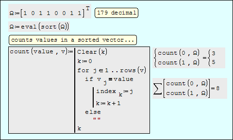

#20 Posted: 12/30/2022 11:05:26 AM
Maybe, that's what you are looking for ?
Maths Convert num2str EXTENDED.sm (6.72 KiB) downloaded 1677 time(s).
