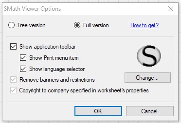

Full version of SMath Viewer is now available for signed in users:

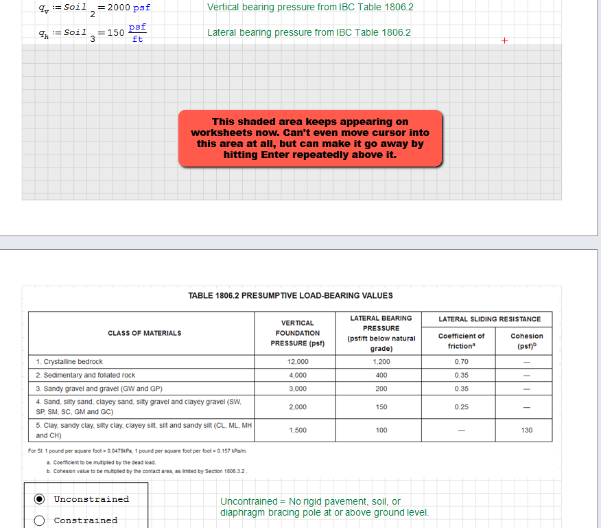

There's also another issue that started appearing in the previous build, but still occurs in this one. See below for a screenshot of the shaded region at the bottom of the page that is inaccessible. The cursor cannot be placed or moved into that area. Trying to move any text or math region into it just makes those items bounce out. Seems to occur when I've had a graphic on the page above that moved down until it no longer fit on the page and moved to the next page. Then it leaves this strange shaded area where the graphic used to be on the upper page. If I hit the carriage return on the keyboard, one line of the shaded region goes away. So if hit Enter a bunch of times, the region temporarily goes away, but comes back later with more editing. Any ideas?
Thanks,
Jason

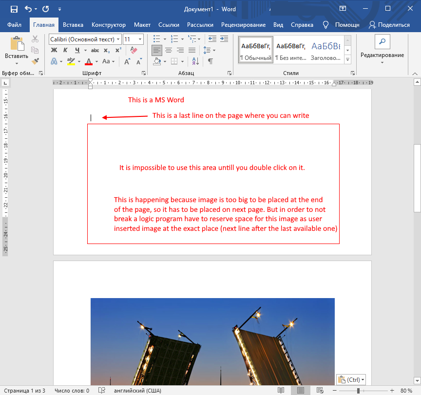

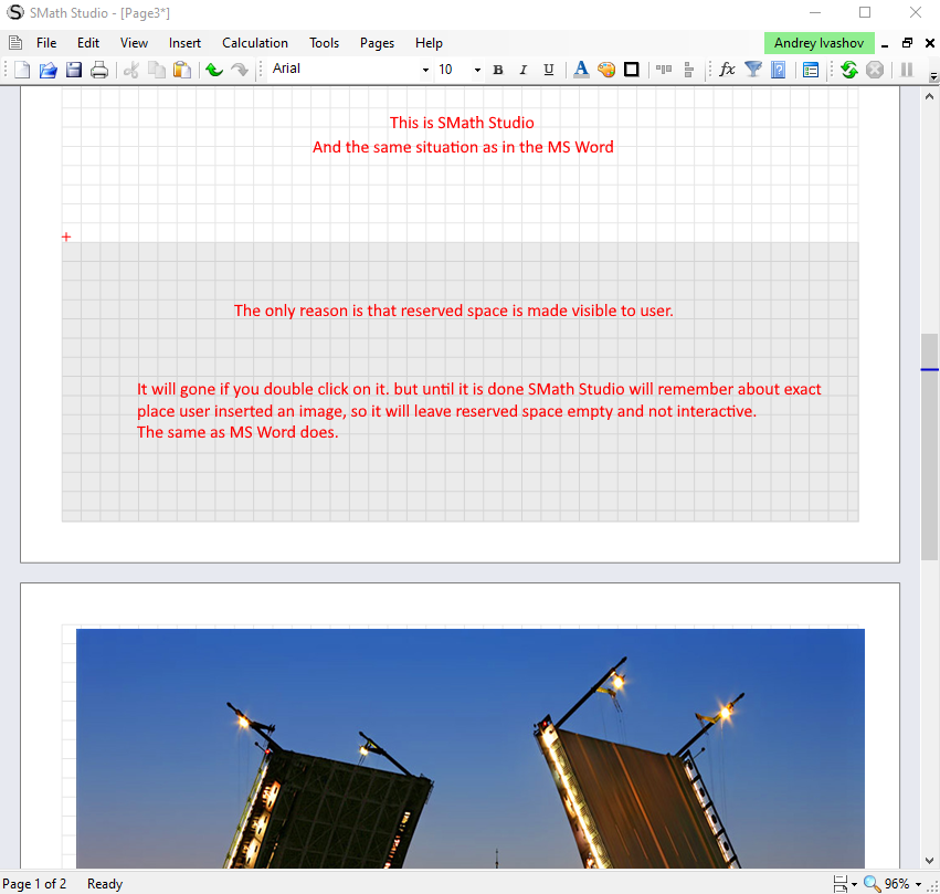

This is by design from the time when Pages representation mode was introduced. Please try to play with MS Word and SMath Studio side by side.
Jason McCool 4/9/2021 11:24:00 PM
#19 Posted: 4/9/2021 11:43:46 PM
Jason McCool
Jason McCool
9 likes in 78 posts.
Wow, 20+ years of using Word and I never knew about that! Thank you for the explanation. I had tried clicking in the space several times but never double-clicking. Glad that one had an easy solution. Thanks! Any suggestions on how the text is displaying in controls?

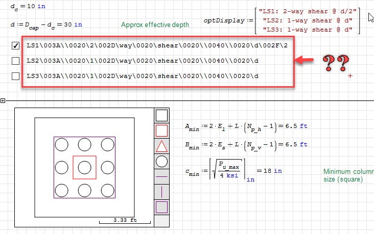

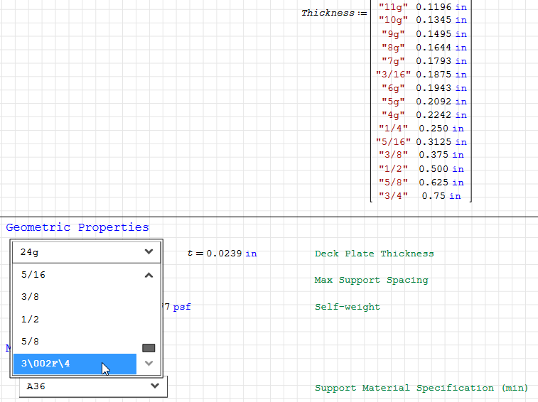

#20 Posted: 4/10/2021 5:11:40 AM
2,345 likes in 4,059 posts.
The reason is in my comment here: https://en.smath.com/forum/yaf_postsm69253_IMAGE-REGION-DOESN-T-WORK.aspx#post69253
I will start correcting plugins today.
