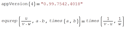

#5 Posted: 8/27/2020 9:24:31 PM
1,139 likes in 1,805 posts.
"equrep() function supports variables/functions replacements now."
Any example about what that means ?
Can you show an application of it ?
An image is good enough.
Thanks ... Jean
Hi Jean. Here: Applications for equrep: expression isolation and laplace transform.
