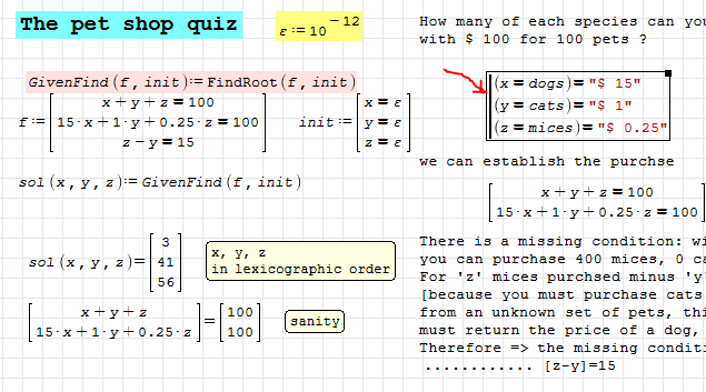

Greetings to everyone.
I have tried to solve a system of nonlinear equations using the "GivenFind" procedure. I've attached two screenshots below with the bugs returned by the program. In the first image, the program has returned: "x - undefined" error, as can be seen. I then defined the vector x, and the program returned the error "GivenFind - the function is not defined" as in the second image. What could be wrong?
#2 Posted: 3/17/2018 8:38:36 PM
It is not an Smath procedure. The native procedure "FindRoots"
Which to me is a non sense as you are given something and want to find.
Solve GivenFind PetShop.sm (13.72 KiB) downloaded 1240 time(s).
Solve TREASURY_1 [Iterate L, Lc].sm (36.5 KiB) downloaded 1076 time(s).

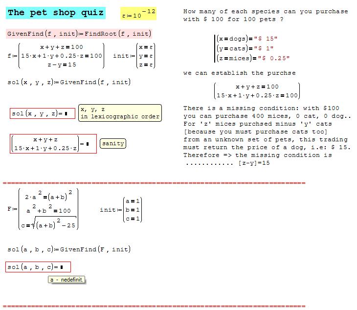

#3 Posted: 3/18/2018 2:49:55 AM
Nicolae Olaru
Nicolae Olaru
1 likes in 115 posts.
Bonjour Jean Giraud.
I tried before, including the way you suggest it. In addition I analyzed some examples I found on the forum. The results were the same. I attach a new image to one of the examples you gave me in your answer. You may notice a similar error. Therefore, please help me solve the problem.
#4 Posted: 3/18/2018 4:05:29 AM
Just suppress evaluation of the marked region.

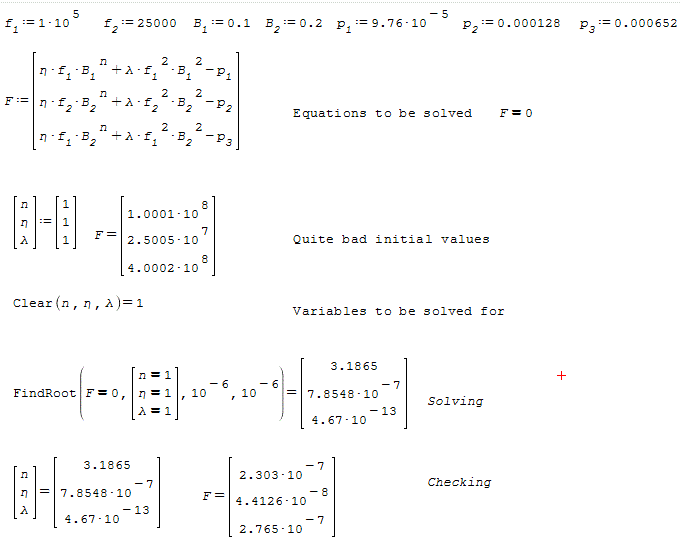

Greetings to all
Here is a practical and very laborious way to solve the initial problem. The three basic non-linear equations are those on a yellow background. The MathCAD program's symbolic calculation facilities were used to solve two of the basic equations in relation to the η and λ variables. The necessary substitutions were made in the third equation and I was able to define the function N (n) in this way. The equation N (n) = 0 is solved using the "solve" function in Smath. A second function (Λ (λ)) was then elaborated which was solved in turn using the same function. Finally, one of the two equations solved in relation to the variables η and λ is actually calculated. The whole calculation process lasted about 60 minutes. I wonder how long it would take if I did not have the facilities of MathCAD's symbolic calculation ?! Probably a lot of hours. What would have happened if (as Radovan had said) the number of variables would have been greater than 3 ?! It would have been frustrating indeed. Therefore, if Smath developers read this post, I think it would be good to consider the possibility of implementing a "Given-Find" and / or "Given-Minerr" computation procedures similar to those used in MathCAD. I attached here along with the image of the Smath solution, a picture of solving the same problem in MathCAD by using the "Given-Find" procedure. It lasted only as long as it was necessary to edit the necessary relationships in that spreadsheet. Otherwise, all the best.
#10 Posted: 3/19/2018 7:51:47 AM
It seems that for your problem there is a solution (do not know if it is a viable one). FindRoot() will do the job here. One might consider FindRoot() similar to Given/Find in Mathcad.
FindRoot3.sm (13.61 KiB) downloaded 1177 time(s).

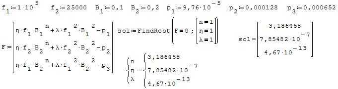

Hello
@Radovan: It works
@Jean Giraud: I can not comment. For now, I've managed to solve the problem. Another time I will see.

Hello
Here's the Smath file. The other was an image file.
FindRoot.sm (8.94 KiB) downloaded 1209 time(s).
