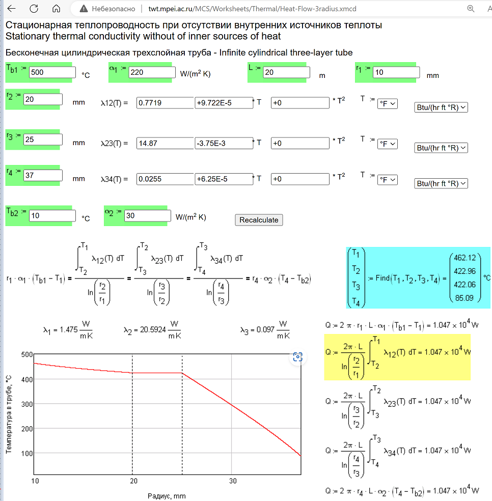

I would like to to sole the linear equations
F1=F2=f3=F4 with 4 unknowns T1, T2, T3 and T4
I can do it in Mathcad (given-find). but cannot in SMath ;-(
Help me please!
See please the Mathcad Calculation Server
http://twt.mpei.ac.ru/MCS/Worksheets/Thermal/Heat-Flow-3radius.xmcd
my SMath try in attach and
Lambda3.sm (434.36 KiB) downloaded 1620 time(s).

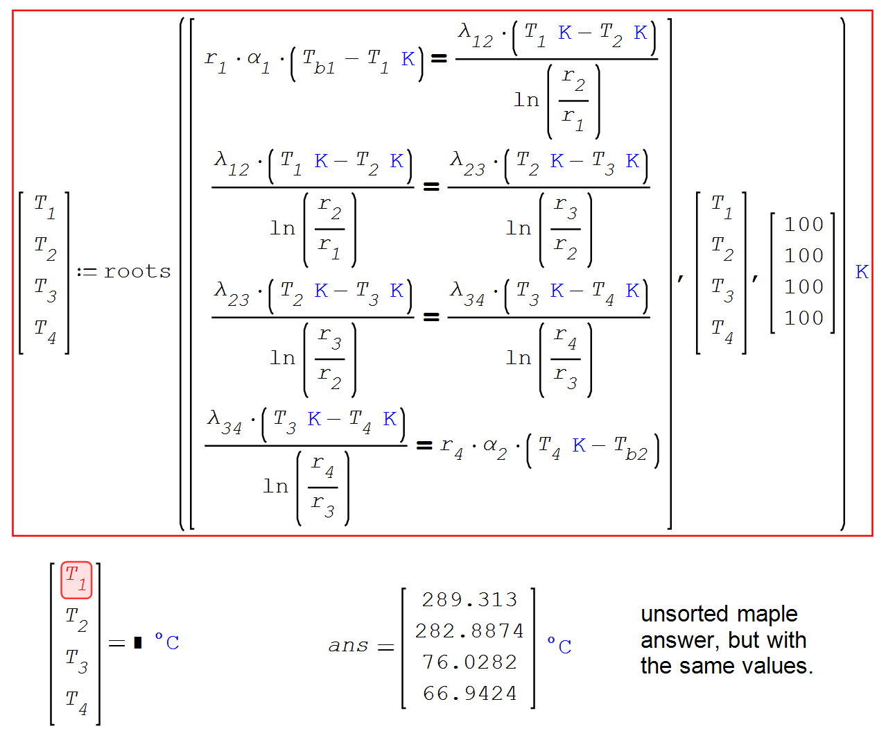

Hi. Here two options for solve the system.
Lambda3.sm (452.05 KiB) downloaded 1625 time(s).

I see Alvaro has beaten me to it, but here's my approach anyway.
Lambda3b.sm (470.18 KiB) downloaded 1675 time(s).

Thanks to all!
My solution in attach
Lambda3.sm (265.4 KiB) downloaded 1655 time(s).
