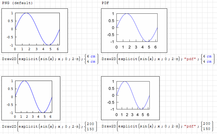

The image shows four image regions with the same graph, format PNG (left) and PDF (right) and size specified in SMath length units (upper) and in pixels (lower). The image regions are reset to original size via context menu. My screen is 96 dpi and at 100% zoom level the scaling is perfect.
