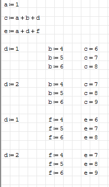

Moreover, using the symbolic evaluation, you cand reach the target defining the parametric variable before the parameters

Thank you both mkraska and w3b5urf3r_reloaded.
I have used w3b5urf3r_reloaded's solution before, but did not think of it this time because I wanted a different flow to the work.
I did not even know about right clicking an equation as mkraska suggested, so that will help me also.
