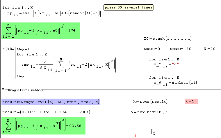

#24 Posted: 10/6/2012 2:24:32 AM
You are right uni, thank you
Now, every F9 produces result for your test problem.
#25 Posted: 10/6/2012 10:06:38 AM
1,558 likes in 1,868 posts.
20 points (~24 sec). I made some little changes in Draghilev() function.
Draghilev's method. NLS. Example 2.smz (6.17 KiB) downloaded 1345 time(s).
Radovan Omorjan 10/6/2012 10:41:00 AM

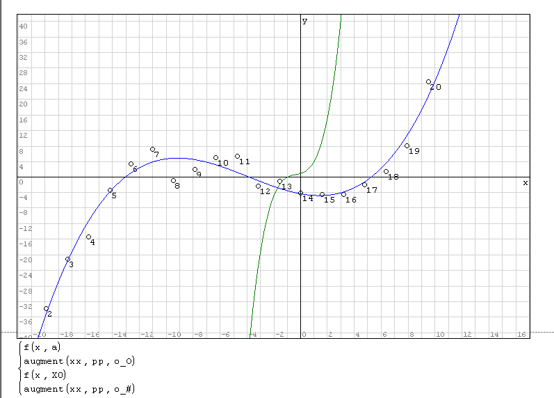

#26 Posted: 10/6/2012 11:02:10 AM
Hello uni,
It is quite interesting that you've made it working with 20 points .
By the way, I've added the sum of squares - just to check how this sum reduces its value.
Вячеслав Мезенцев 10/6/2012 11:12:00 AM
#27 Posted: 10/6/2012 11:17:30 AM
Yes, but initial value for a is X0 := stack(1, 1, 1, 1)
#28 Posted: 10/6/2012 12:20:33 PM
Sorry, uni, my mistake . Graph distracted me
In this example - this is really amazing
If this could work for a bit more complicates functions - it would be really great .
Вячеслав Мезенцев 10/7/2012 4:02:00 AM

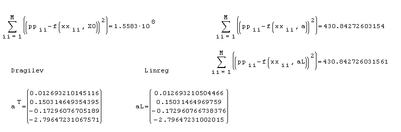

#31 Posted: 10/7/2012 6:20:29 AM
Hello uni,
It seems very promising
As it is basically a linear regression over parameters (polynomial equation) I just added the result of it - just for checking. The results are very close to each other. It is interesting that the method is working on this problem very well
The determinant [MATH=eng]det((transpose(XX)*XX))=2.40082615642816*10^16[/MATH]is rather far from zero - well conditioned system. I suppose that would be very interesting to see what will happen when this determinant is quite close to zero - ill conditioned system. I suppose that the results must be quite different.
Вячеслав Мезенцев 10/7/2012 6:35:00 AM
#32 Posted: 10/7/2012 6:34:11 AM
Quote
Yes, it would be interesting. I'll try to find an example. To improve accuracy, we can increase the parameter N. As for the more complex functions, I'm working on it.
Radovan Omorjan 10/7/2012 6:37:00 AM

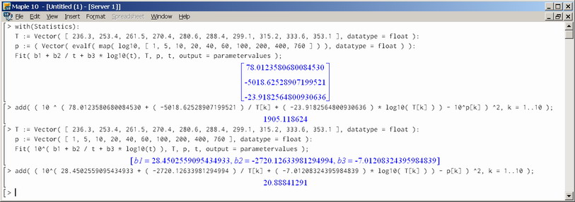

#34 Posted: 10/8/2012 5:42:03 AM
Radovan, it's really hard to get a solution using the Draghilev method. I do not know how to do it yet.
The solution here is: [28.4502559095434933, -2720.12633981294994, -7.01208324395984839]. Maybe later I'll be able to get it.
Davide Carpi 10/9/2012 3:32:00 AM, Radovan Omorjan 10/8/2012 8:02:00 AM

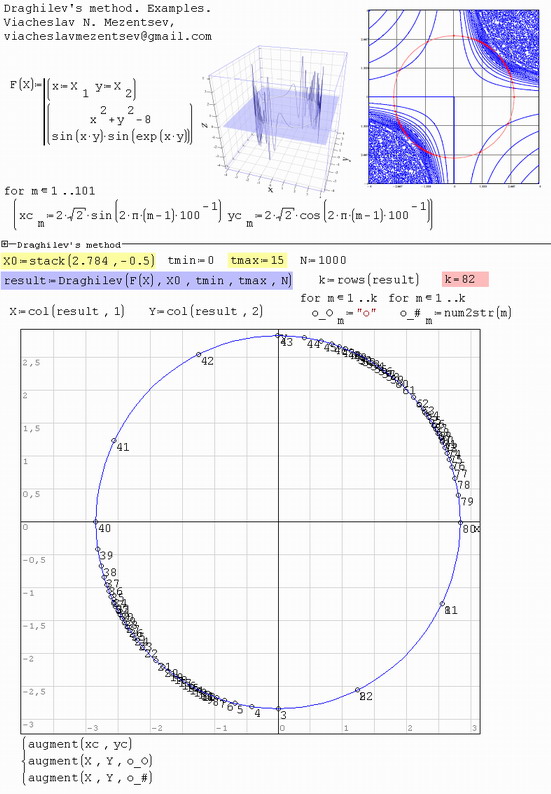

Example 5. Finding roots: System 4.
[MATH]sys(x^2+y^2-8=0;sin(x*y)*sin(exp(x*y))=0;2;1)[/MATH]
I made minor changes to simplify the calculations. Function has become more clear.
Calculation time: ~1.5 min
Roots: 80
Radovan Omorjan 10/11/2012 2:36:00 AM
#39 Posted: 10/11/2012 2:13:05 AM
алексей
алексей
17 likes in 78 posts.
x1^3+x2^3-0.1e-1*sin(1.0001*x1+x2)=0;
One equation with two unknowns or implicitly given function. In the figure we can see the points at which violated the conditions of existence of an implicit function.
Draghilev's method.
x1 and x2 are solutions of this equation and are functions of the arc length, which allows a clear move along places where there are no implicit function in the classically accepted terms …
