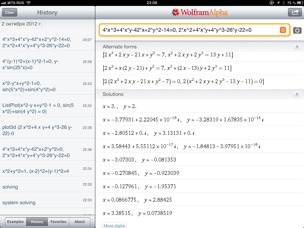

Example 1. Finding extremes: Himmelblau's function:
[MATH]f(x;y) : (x^2+y-11)^2+(x+y^2-7)^2[/MATH]
[MATH]sys(4*x^3+4*x*y-42*x+2*y^2-14=0;2*x^2+4*x*y+4*y^3-26*y-22=0;2;1)[/MATH]
P. S. Buchberger's algorithm can solve systems like that much easer.

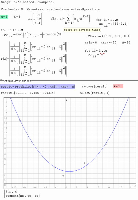

#9 Posted: 10/4/2012 6:47:37 AM
#10 Posted: 10/4/2012 7:36:12 AM

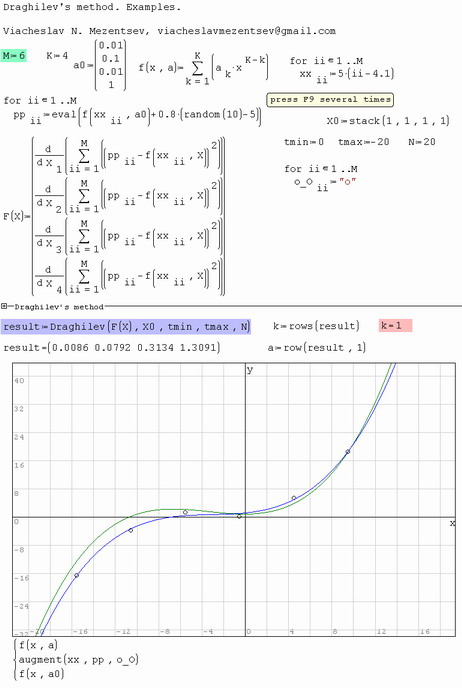

But it is possible.
P.S. This is not a correct example too, the determinant is zero. The sum of squares must be on all points.
Draghilev's method. Approximation. Simple example.smz (5.77 KiB) downloaded 1451 time(s).
#11 Posted: 10/4/2012 9:05:42 AM
Hello uni,
Thank you for considering this
. If you include the sum of squares to your example above, then it is equivalent as finding the roots of this three equations
[MATH=eng]sum(((el(pp,i)-f(el(xx,i),a1,a2,a3))*diff((f(el(xx,i),a1,a2,a3)),a1)),i,1,n)≡0[/MATH]
[MATH=eng]sum(((el(pp,i)-f(el(xx,i),a1,a2,a3))*diff((f(el(xx,i),a1,a2,a3)),a2)),i,1,n)≡0[/MATH]
[MATH=eng]sum(((el(pp,i)-f(el(xx,i),a1,a2,a3))*diff((f(el(xx,i),a1,a2,a3)),a3)),i,1,n)≡0[/MATH]
It is a well known and maybe redundant to say, sorry - the first derivatives over three unknowns (a1,a2,a3) should be zero. The Jacobian of these three equations should not be zero (say, giving all xx different).
The problem is in derivatives, Jacobi matrix etc. (includes summation and quite large expressions). Whenever I tried to solve this root finding problem in SMath, finding derivatives, Jacobian etc. causes the main problem.
Anyway, could you please try to solve with this method the three above equations using your example function, but with more than three points.
P.S. I just saw that you added smz file as well. I might try myself ass well
- but have doubts that I would be successful

#12 Posted: 10/4/2012 9:54:18 PM
Radovan, I can't say something in your case. Yes, there is a problem with the Jacobian. I can't understand what exactly is the problem, so we turn to a simple example for now.
Draghilev's method. Finding roots. System 2 version 0.2.smz (7.06 KiB) downloaded 1433 time(s).

#14 Posted: 10/5/2012 2:44:40 AM
Thank you uni for your time,
I also tried your simple example yesterday and was surprised that it worked well, but for some data worked well and for some other did not - as you mentioned.
I will try this new example as soon as your server become available (temporarily down at the moment)

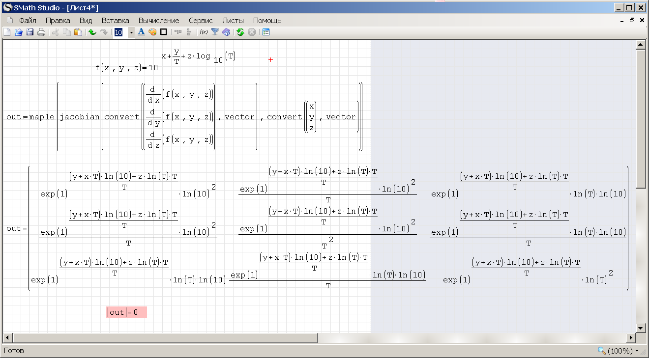

By the way, I bumped many times into the derivative, gradient, Jacobian problem in SMath and almost always had to give it up. I even asked Andrey few times to introduce numerical differentiation in spite of the well known fact that numerical differentiation is prone to numerical errors. Calculating even derivatives (Jacobian is another nightmare) analytically is sometimes almost impossible and there is no other way than using some kind of numerical approximation. Therefore, when Jacobian is involved in some calculation - I always find myself unconfortable
EDIT: You are right - Pressing F9 several times can make it work. The error message was always "Action could not be performed with text" .
By the way, I even get the results of this function
[MATH=eng]f(x,a):sum((el(a,k)*x^{K-k}),k,1,K)+sin(x)[/MATH]
but after pressing F9 quite a lot of times.
#15 Posted: 10/5/2012 8:10:05 AM
Unfortunately, the plugin can't correctly translate all that much data with which it communicates with the Maple. Do not forget to delete the file mvr5.txt. Here you can see the language in which the plugin communicates with the Maple. And one more example. I increased the dimension of the problem and the number of points.
Radovan Omorjan 10/5/2012 8:27:00 AM
#16 Posted: 10/5/2012 8:42:50 AM
Thank you uni,
Still pressing F9 lots of time is needed.
Wish you good luck in resolving this problem and improving the plugin

#17 Posted: 10/5/2012 9:09:37 AM
Press F9 need to generate random numbers. I think that this should be on the expression where it is described (inside it). I get the result after every of 5-7 pushing. You can also increase the spread of the points (instead of a factor of 0.8 to take a little more).
Hmm. As I see it, in SMath used arc*() style, isn't it? (Russian interface) If Europe is different, I need to give a complete list of mathematical functions, where you need to make corrections, and three letters of the interface language (or just language name).
P.S. Radovan, I think that you need something like this: Nonlinear Regression II, Fitting a Curve to a Data Set with the New Gradient Operator

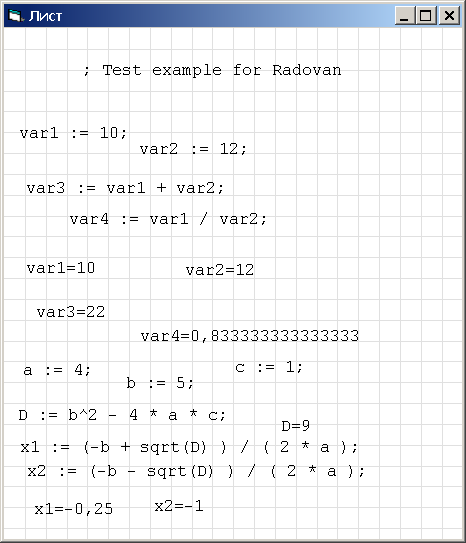

Radovan, if you want to understand it better, then you need to try to write the interpreter symbolic computation by yourself. It's not that hard. There is even an introductory book - Computer Algebra with SymbolicC++.
P.S. On the picture is a simple example of the SMath-style calculator, which is written in VB6: sources (draft, russian).
