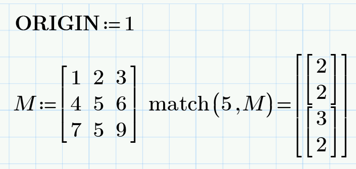

Hi
Is three the Mathcad-function match in SMath
In Solver 30405, we have a more advanced version ... last page.
Utilities Lookup TREASURY GOLD Copy.sm (498.21 KiB) downloaded 1397 time(s).

Hi
You can check this post: https://en.smath.com/forum/yaf_postsm3742_lookup.aspx#post3742
