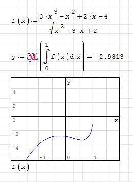

I have the following problem, trying to solve the definite integral int((3*x^3-x^2+2*x-4)/sqrt(x^2-3*x+2),dx,0,1): I get the error "x - not defined" and, of course, no result.
If I change the limits to [0..401], I get a result (!) with no error message, but if I set the upper limit lower than 401, I get the error again...
What is the reason for that?

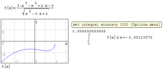

#3 Posted: 2/7/2019 11:41:17 AM
The integrand is undefined @ x = 1
Three verdicts in there:
1. Nothing will integrate that freak above x=1.9999999999999999999999999999
2. Nothing will integrate up to x=0.99999999999999999999999999999999
3. Can only integrate in reasonable range of the integrand.
Interesting Classroom example ... always plot the integrand !!!

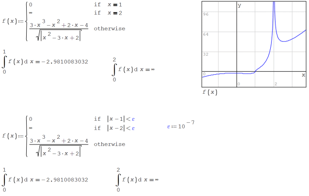

Hi. I think that here the point is how to handle avoidable discontinuities in SMath. Because integral and other operators or functions not accept the 'if' statement, you can use 'cases' in the definition of f, as this:
Even this isn't the case, this other is more general for avoiding numerical issues with avoidable discontinuities:
sergio 2/8/2019 8:59:00 AM

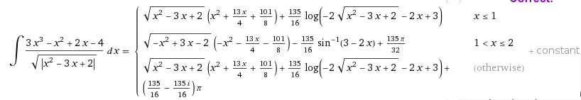

... This other isn't avoidable discont, but can be handled in a similar way.
Well, actually, the integral converges for x=2, as one can see in this wolfram result
That's means that numerical procedure for computing int in SMath needs some improvements.
