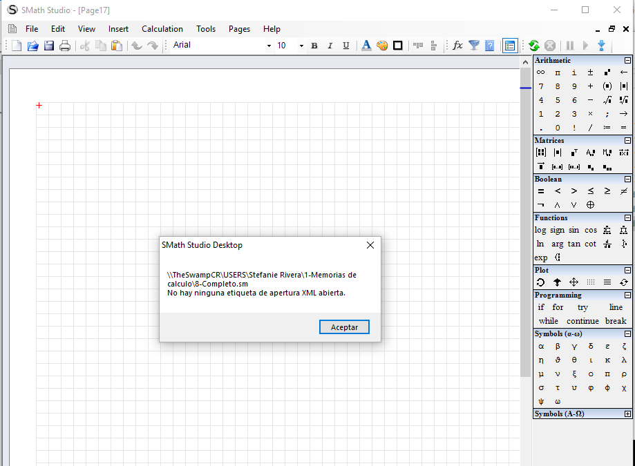

This week I have had this error repeatedly that the smath closes and then it puts this error and the document cannot be reopened.
It is the same error as this case https://en.smath.com/forum/yaf_postst17423_-SS-4609--No-XML-start-tag-open.aspx
Could someone tell me why it happens and how i can avoid it?

I can´t find the file, I erase it and work on a back up file, but when it crashes again i will upload it.

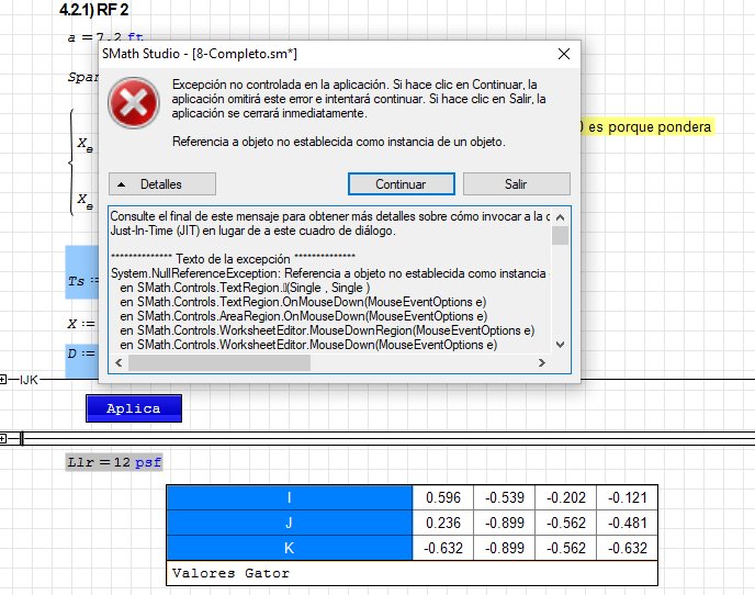

But it crashes several times sometimes with this the error in the image and sometimes just save it normal and the next day when you open it shows the xml error and don´t open more.
The file its large, like 37 pages.
Other times shows this error and dosn´t open more:
This is the complete details:
error sm.txt (16.23 KiB) downloaded 1281 time(s).
#4 Posted: 3/18/2020 3:36:07 PM
WroteOther times shows this error and dosn´t open more:
This seems related to something messed up in a text region (a children region maybe), triggered by mouse-click. Hard to catch without a file.
