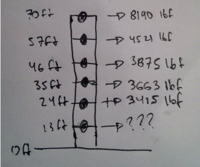

Maybe it is because it is getting late and it has been a long week, but I just can't seem to program this in an elogant way.
I have a force at a given elevation. I am trying to find the total moment at each elevation. See attached it should clear things up.
Note I am ok with completely abandoning the technique I have shown.
Summing Overturning Moments.sm (10.66 KiB) downloaded 1416 time(s).
Thanks in advance!!
Thanks in advance!!

I'm sorry, I must have been getting pretty tired. ioan has accurately described what I am trying to accomplish. Basically I'm trying to building a matrix with the total overturning moment at each floor due to the forces above. I actually didn't think to use a process like ioan has shown and it seems obvious now (although I still need to 'code' it). Basically the sum of the moments above plus the total shear force above applied at the top of the floor.

The equation you proposed is something similar to what I had previously and I can't quite figure out how to adjust it so that it works at each floor.
The problem is that i starts at one and goes to whatever I define on top of the summation. However if I try to adjust the variable on top of the summation then I get the wrong answer. i.e. for the top floor i=1 the summation gives the moment for the bottom floor due to the force applied at the roof. However what I'm looking for is the overturning moment at the top floor (below the roof) due to the force at the roof. So i for Vsw needs to be 1 and i for Z.sw needs to be 5.

For that last updated file you posted, isn't Msum=0 not needed? As well as summing Msum to whichever variable?
Also shouldn't the vector of floor elevation be the same length as the vector for shear force? So that the first floor is at 13.5ft of elevation?
#8 Posted: 10/30/2015 4:43:04 PM
I agree with ioan92, it should be horizontal (or lateral) load.
I also think that there is a force missing for one of the floors so that the elevation and force vectors are the same length. I entered it as 0kips in my example.

Sorry, busy day today. Looks like you guys have it figured out.
It is typical in my region to say "shear" because it is a 'shear'wall or the diaphragm shear due to lateral loads. However you are are correct, these are lateral forces (wind, EQ).
Thanks again for your participation.
I will give your functions and graph a try as they look much better than mine, but it appears that my "for" loop finally had the right answer (see "Summing Overturning Moments_2.sm")
