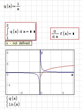

Why it is not working?
Basile
#2 Posted: 5/21/2016 4:32:29 AM
127 likes in 342 posts.
Basile,
disable the plugin Maxima

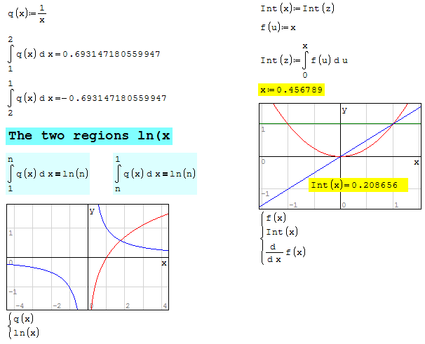

#3 Posted: 5/21/2016 8:47:42 AM
Try the formal procedure before uninstaling Maxima.
The remaining of the work sheet may not work at all.
#4 Posted: 5/21/2016 9:13:23 AM
read more
#5 Posted: 5/21/2016 1:46:20 PM
Basile
Basile
8 likes in 172 posts.
I am using latest build of SMath and Windows 10.
Basile
#6 Posted: 5/21/2016 4:22:47 PM
1,442 likes in 2,933 posts.
You have to use maxima takeover as explained here, otherwise disable or uninstall the plugin.
#7 Posted: 5/21/2016 9:45:44 PM
If version(s) past 5346 disable the integration operator,
to me : it is a bug by definition as exemplified earlier.
#8 Posted: 5/22/2016 2:54:27 PM
Found the issues, I'll commit the fix ASAP
