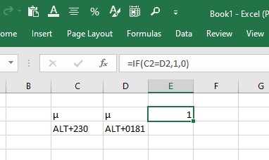

#4 Posted: 3/21/2022 10:43:47 PM
WroteSMath does not recognize the 'micro' sign when it is typed in directly. Could this be changed?
Hi. You're right, SMath can't recognize the difference. But MS Excel neither, or at least I cannot define in excel one that is different from the one called 'micro' in the windows' character map.
Mu-Micro.xlsx (8.22 KiB) downloaded 1355 time(s).
