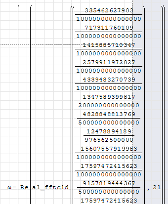

The problem seems that inside the functions stack/augment works in symbolical mode, and the input in symbolical mode is the one below, that is not managed by stack/augment (not sure if correct for symbolical calculations, bug or missing feature).
2016-03-18 12_06_27-SMath Studio Desktop - [Fourier al_fftc1d_[ALGLIB][DEBUG].sm_].png
You have to place an eval() inside fft2D to force a numerical result.
Fourier al_fftc1d_[ALGLIB][DEBUG].sm (101.29 KiB) downloaded 1353 time(s).
