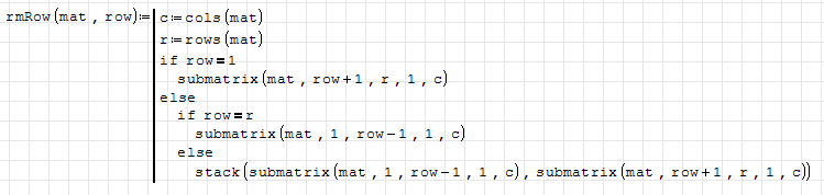

#2 Posted: 11/20/2014 3:51:49 PM
If I remember correctly there is some snippet about this task in the forum, even if I can't find it...
Anyway this should help (in the same way you can delete a column or add a row/column)
edit: another way Language-Integrated Query (Linq)

#3 Posted: 11/20/2014 5:11:51 PM
1,555 likes in 1,867 posts.
Quote
rm.sm (10.84 KiB) downloaded 1409 time(s).

Thanks to both of you for this.
Sorry for the delayed response.
