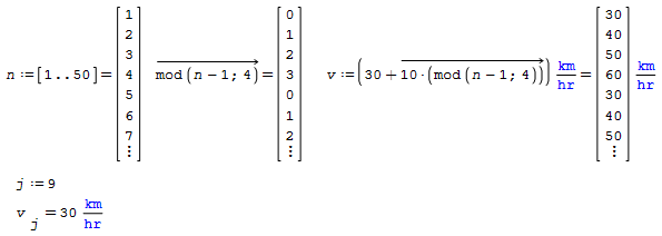

#2 Posted: 3/12/2024 5:18:17 PM
1,361 likes in 2,275 posts.
Worksheet6.sm (4.8 KiB) downloaded 1602 time(s).

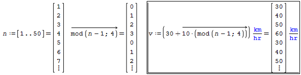

The procedure is to get a vector of the potential values which can then be accessed by index.
You also could implement it as a function v(n) = 30 + mod(n-1, 4)*10

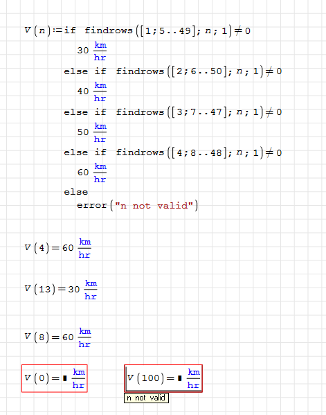

#8 Posted: 3/18/2024 9:19:04 PM
If you have a limited set of choiches, this might be a solution.
Also, I think Martin has a point, since these "n" values should come from some formula.
