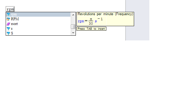

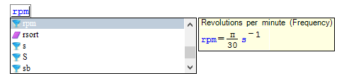

please read here (SS-2395) (you can vote and comment it), here or here (and other...)
base unit of a revolution is coded as 2pi radians (not 1), hence the multiplication factor.
![2018-04-11 15_33_50-SMath Studio - [Page1_].png](/en-US/files/Download/eNUZE8/2018-04-11-15_33_50-SMath-Studio---[Page1_].png)
Arie 4/11/2018 10:42:00 AM
#3 Posted: 4/11/2018 10:41:00 AM
This is because the standard unit in SMath for rotation is radian = 2*pi which is ~6.28. If you look at the definition of rpm it is pi/30 1/s or 2*pi/60.
In order to get the right result you need to divide by 2*pi. What i would suggest is creating your own unit for RPMs as done in the attached.

#4 Posted: 4/11/2018 11:42:37 AM
WroteThis is because the standard unit in SMath for rotation is radian = 2*π
... and this is because trig functions are numerically approximated in radian.
Those functions are native in Microsoft, used by math software as is.
