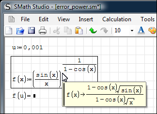

Any ideas on what is going on here (it is to check a limit numerically for a question posted on mathhelpforum):
(the limit is exp(-1/3))
CB

Is it because the function definition is not respecting the order of evaluation implied by the brackets?

This is known problem. The only way to beat it is to use workaround with round(...) function as shown on the screenshot below:
This will be fixed later.
P.S.: The same type of error reported here: x^y=error.

Thanks. I think I prefer the other work around from the other thread:
since it forces the order of evaluation.

To fix this I've added new useful option for every Math region, calls "Optimize evaluation".
It is possible now to prevent optimization of the function/variable definitions by symbolic library. Turning off the optimization can cause reducing of the evaluation performance, but it can increase it in some cases too. Also this feature can help to solve some possible issues in the future. See pictures bellow for further explanation:
Figure 1: Document with evaluation error.
Figure 2: Switching off control's optimization.
Figure 3: Document without evaluation error.
Feature will be available with the next SMath Studio release.
Regards.
