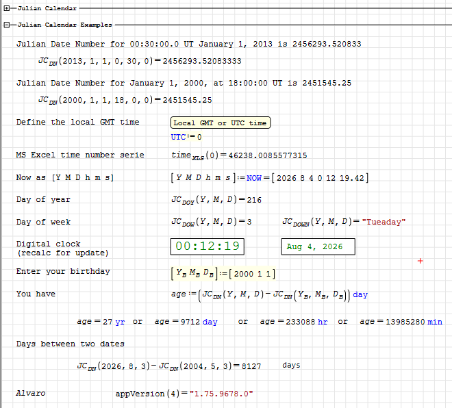

SMath Forum SMath Studio Questions Simple Date Calculation 1 Pages (2 items) Simple Date Calculation - Apologies I can't seem to find syntax for dates - Messages Go to last post #1 Posted: 8/3/2026 11:04:42 PM Alan O'Connor 0 likes in 1 posts. Group: User Just looking to calculate number of days between datesI feel I should be able to find this myself .... bit of a noob here #2 Posted: 8/4/2026 12:15:59 AM Alvaro 1,139 likes in 1,805 posts. Group: User Hi. You can try the tools in this post: https://smath.com/en-US/forum/topic/8UdBUE/Julian-Calendar-UtilitiesJulianCalendar.sm (41.79 KiB) downloaded 390 time(s).Best regards.Alvaro. 4 users liked this postRafael H Padilla Velázquez 8/4/2026 2:05:24 AM, sergio 8/4/2026 8:23:39 AM, ioan92 8/5/2026 7:35:37 AM, NDTM Amarasekera 8/5/2026 2:19:55 PM 1 Pages (2 items) New Posts No New Posts
