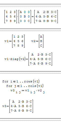

i have a litte Problem an I am not able to figure things out even with the handbook.
It seems to bee a quite simple Problem.
I got an 6x6 matrix and i want to multiply every cell of a collum with an other factor.
I am only able to multiply every cell with a factor.
Because i have a huge number of those i want to do it with a loop.
I hope my description was well enough
thanks in advance

Construct your generalised vectorising algo.
Get inspired from the attached.

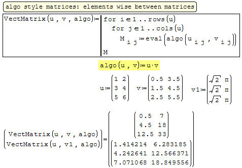

More generally:
1. accomodate rectangular systems
2. define your own multiplicand
3. assign the "algo" processing

1. Refactored a bit
2. Read more stuff and examples
