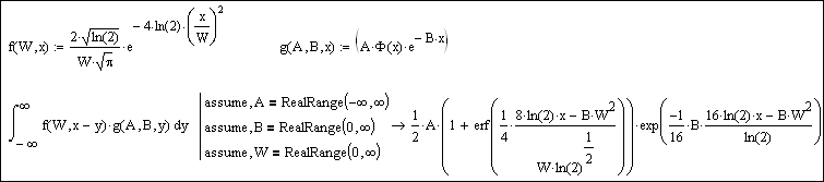

#1 Posted: 10/1/2018 8:55:22 AM
Just confusing it does not evaluate correct Φ(0)=0.5
Bug Heaviside.sm (10.27 KiB) downloaded 1352 time(s).

#3 Posted: 10/3/2018 12:58:26 PM
Thanks Alvaro.
True: only Mathcad recognizes Heaviside as a function
However, Smath proceeds the convolution integral alright.
Convolution Numerical [WORKING model].sm (33.32 KiB) downloaded 1125 time(s).
Convolution Numerical [Unsolved MCD] Copy.sm (243.32 KiB) downloaded 1183 time(s).
